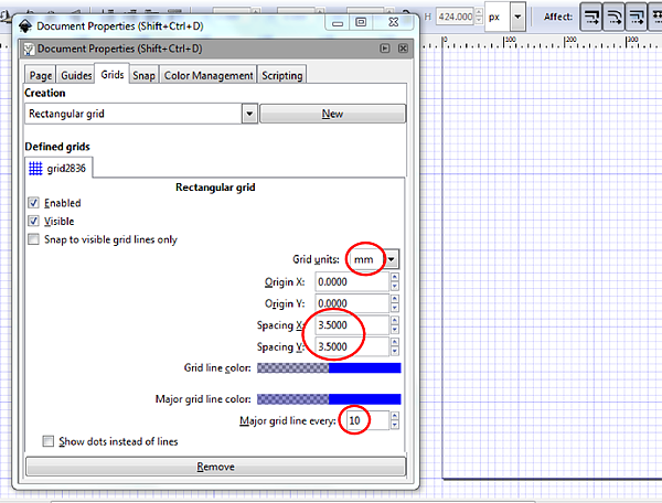

There’s no need to guesstimate. Use the grid in Inkscape and set the X and Y spacing to 3.5mm (a scale foot in HO is 3.5mm.) Then scale the black rectangle and white lettering to the scale size you want. If the rectangle is supposed to be four feet by two feet with letters one foot tall, then the rectangle would be four grid units by two grid units, and the letters one grid unit tall.
You’ll need to size the page layout in the Page tab to the size of the decal sheet you’re using.
