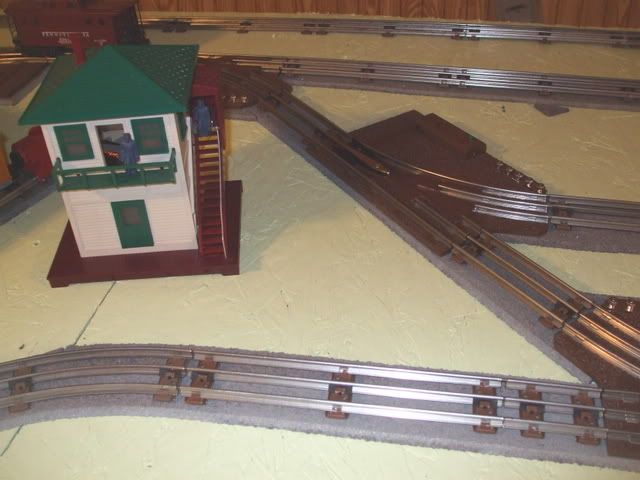

To help blend the switches into the layout, I have painted the switch ties and the area around the switch to somewhat match the color of the surrounding area. I used acrylic paint and one advantage is that if you want to go back to the origional plastic color, the acrylic paint can be easily scrubbed off. Here is a photo.

Dave - Those switch tracks look shiney. How did you get them looking like that? Did you use sandpaper/wire brush? How do you keep them from oxidating if you’ve used sandpaper/wirebrush which removes the tinplate?
lionel2986 - The switches were dirty and somewhat corroded when I got them. I cleaned them with wet sandpaper and steel wool. Then I applied WD 40 and rubbed it off. It has been about 2 years since the switches in the photos were done so that is how they look now, still no rust or corrosion.

Those switches are really sharp! They blend in really nice. I really like the indicators you’ve put on them.
