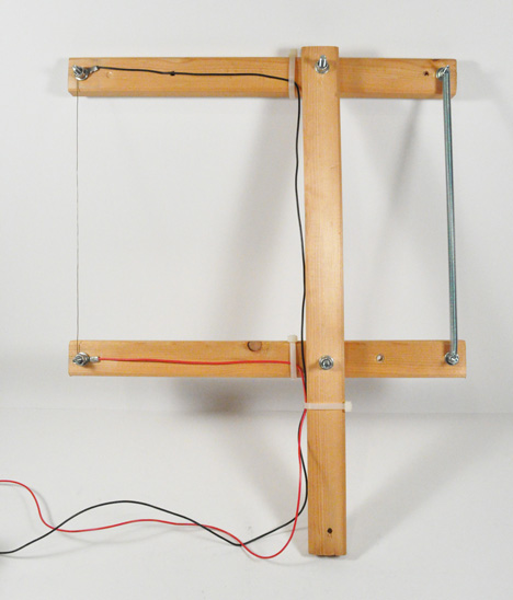

cardboard (cerial box, not corrugated) can be taped temporarily to the side of styrofoam block and used as a guide for a hot wire using something as cheap as the one below or something more expensive. this means the grade has to be built up from foam that’s not too wide. Once cut, additional foam could be added to the side. but the cardboard templates are a bit more complicated if the grade is curved, each template is different. Multiple piece of cardboard can be taped together to make lengthy templates
