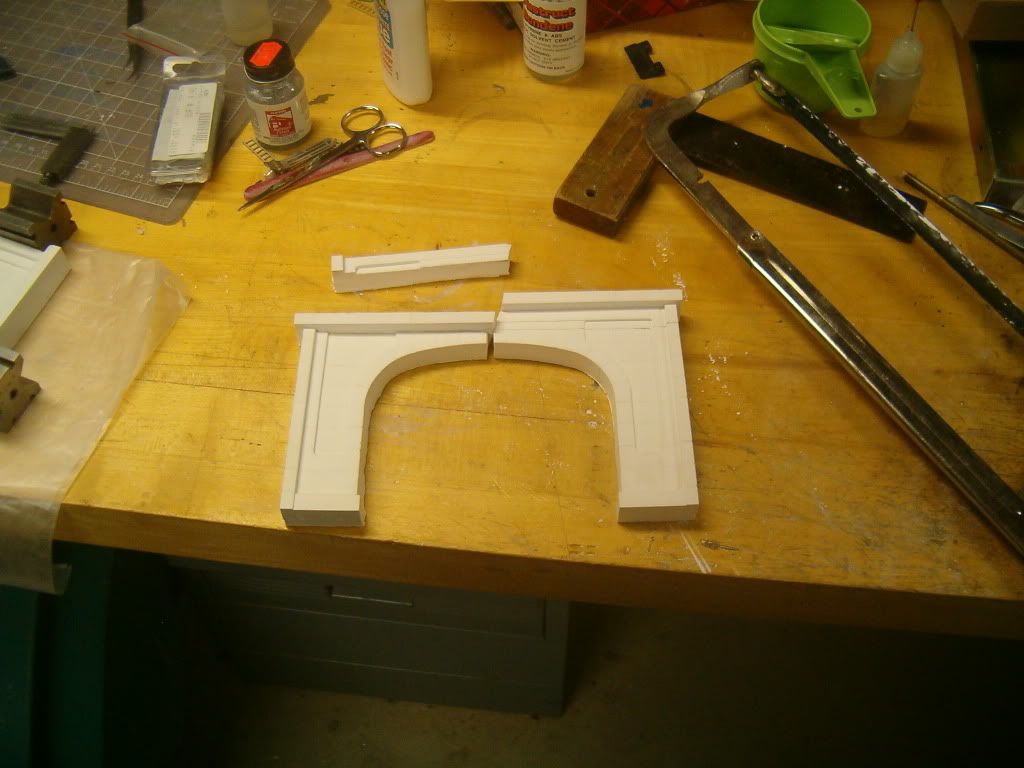

A fine tooth hack saw blade is how I’ve done it. Remember to clean the blade a couple times during the cut to prevent binding, which will cause the blade to crack the casting. Here’s a two track tunnel portal I lowered to fit my scenery better. It was reassembled with simple white glue. Wax paper will keep it from sticking to the table.
