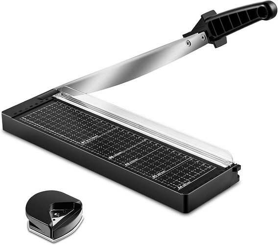

Are you using scissors?
I wouldn’t use scissors, I suggest to use those paper cutters that teachers used in school when they split sheets of paper in half
Okay, I’ll have to check that out!
I can find one too if you need me to, I know a few places that sell them for a good price and they are new
Cool, I’ve been using a combination of Exacto knives and a Dremel, so that was probably also a factor.
Here ya go @Bigguy511
Dremels are kind of hard to use same with Exacto Knives
Thanks man! I’ll be grabbing that lol
