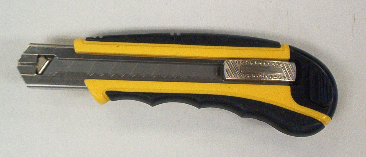

I use those cheap retractable razor knives and a straight edge. The ones with around a 6" retractable blade that has the break off tips.
Yes, you can score and snap the foam sheets. It will snap cleaner if it is cut with the length of the sheet compared to across the sheet.
I usually score it a couple of times with my razor knife, then snap it to finish the cut.

I Have been in the building industry for years now and we cut it 2 ways, when I have put in 2" between ceiling rafters in a garage, we rip them on a table saw or a 7.25" Skil Saw. We also use the knife that tsage has pictured, the saw method make a mess though. When cutting with a power say, use a carbide tip blade and finer tooth.
