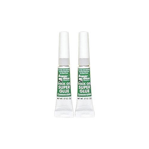

The only Super-Glue I use is the Super-Glue gel. It won’t run all over the place and pretty much stays put while I work with it.

I now use the little tubes of CA you get at big box retailers in multi-paks (this one claims to be the original Super Glue), mostly because the big bottles of Insta-Cure seem to harden and dry out way before I use it all, and the resulting joints from either seem about as strong (and hopefully as long lasting)…
