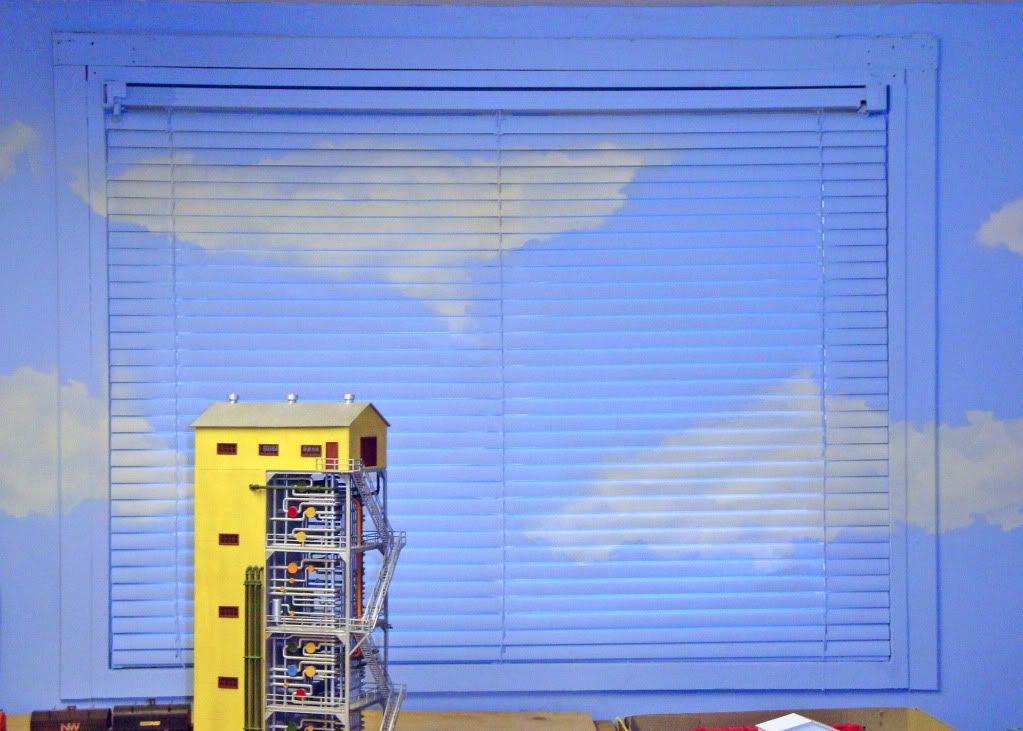

When I took over an 11x15 room for the layout, I bought some custom small slat metal blinds in a sky blue color. My backdrop is painted over the window sill and surrounding area and fortunately the bottom of the window blinds is about a foot above the layout level.
If your window goes below the layout level, I would by the blinds and close them and paint the backdrop right on the blinds. You would be surprised how they just blend in over time and you don’t notice it.
