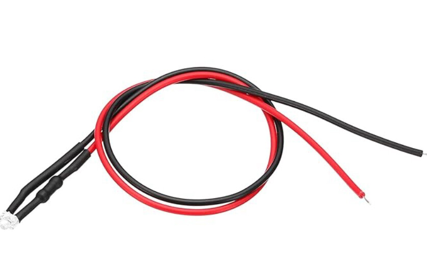

Thanks Rich. I see some 12V LED online less then a buck each ill give that a try and hope i didn’t destroy thwt function on the decoder.
Just be sure to add a resistor to one leg of the LED. It doesn’t matter which leg gets the resistor as long as one leg does get a resistor. Use a 1K resistor.

It’s not hard to find LED’s already wired to the proper resistor. I’ve got a whole box of them for 12v.
Thanks everyone for these tips. The ones i ordered are warm white, 1.8mm and come with a resistor pre wired.
I wont be surprised if i have to relocate the resistor as its current placement doesn’t look to good for getting it into a tight spot in front of the boiler.
$17.00 for 30 of them (and thats Canadian bucks so even cheaper by most standards i guess.). I figured if they didn’t work for the loco we can always use them to light up buildings and the such. Ill look into those Evans ones. If these dont work for me.
That pre-wired LED should be fine, and there should be no need to relocate the resistor.
To get it to fit into the housing, you may need to shorten the two wires.
