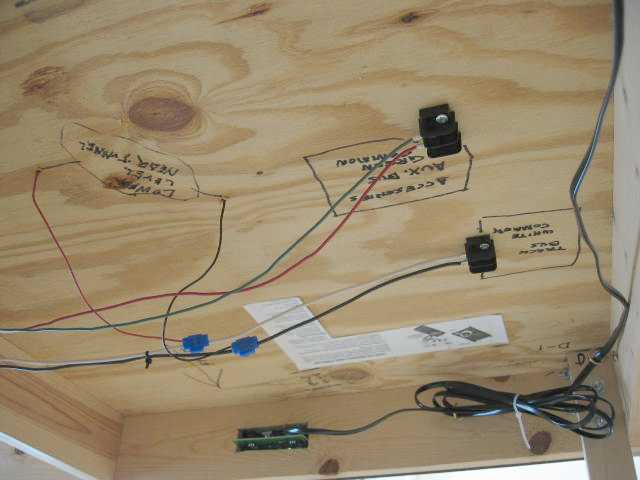

a-nut,
Here’s a simple bus (black and white) terminating at a 2-terminal strip. Track feeders are connected to the bus with blue “tap-in” (Or “suitcase”) connectors. The bus is 14ga and the feeders are 18ga.
The red and green is an accessory bus.
