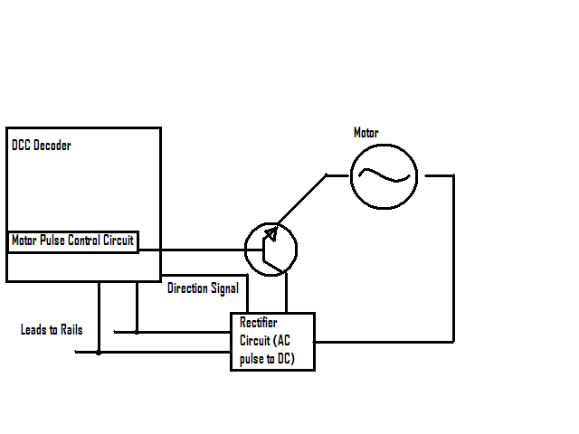

So I am of the conclusion that the 12 Volts at the rail are not making it to the motor. This does not make any sense as any parallel circuit delivers the same voltage across the terminal points. The only thing that will increase is the amps. It should be designed like this:
So somewhere the internal circuitry of these DCC sound decoders are cutting back on the voltage delivered to the motor termin

Well, the first volt and a half or so get eaten in the rectifier, to start, before the decoder can come to life. And with a motor, it’s really more about the voltage than the current, so you can’t just increase the current. If you increase the current, the voltage drop across the motor goes up, but if the voltage isn’t there, you can’t increase the current. A motor isn’t an LED.
The biggest point is the one David made, it’s a DCC decoder. DC is, in a way, a parlour trick. That they are happy to sell you.
If you have 12 volts on the rails, the most the decoder can apply to the motor is approximately 10.6 volts because of the voltage drop of about 1.4 volts as the voltage passes through the rectifier.
If the DC power has any kind of pulse, or if it lets through a lot of AC ripple, some decoders do not deal with that very well, which may be the cause of the stuttering you were talking about.
Did you check the voltage at the rails with or without the locomotive(s) on the track ? If without, then recheck with the locomotive on the track and the voltmeter not too far from the locomotive. It is possible that you either have some current limiting or source resistance loading down the voltage to the locomotive.
