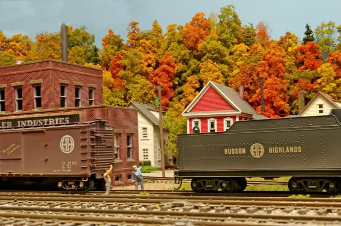

Tom, that really isn’t true. I’ve been making my own decals for better than a dozen years, overcoating every sheet I’ve ever done with Crystal Cote and never encountered any setting or film-hiding problems. In fact, my decal applications typically show not trace of edges at all. See the example below.
The simple fact is that you only apply a very thin overcoating, typically using an airbrush so that you can exactly control the amount of overcoating being applied. If one attempts to do the same thing with a brush, or rattle-can, that’s when you run into trouble.
Notice that there is no trace of decal film associated with the decals on either the tender, or box car, as well as how the herald decal has set completely over the rivet detail.
