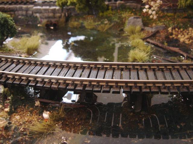

This is my biggest water feature, which I sometimes call my “$50 River” because it took that much two-part resin to create. It took three pours, IIRC and is about 1/2" deep at the deepest. It has very good depth and looks deeper than it is.
