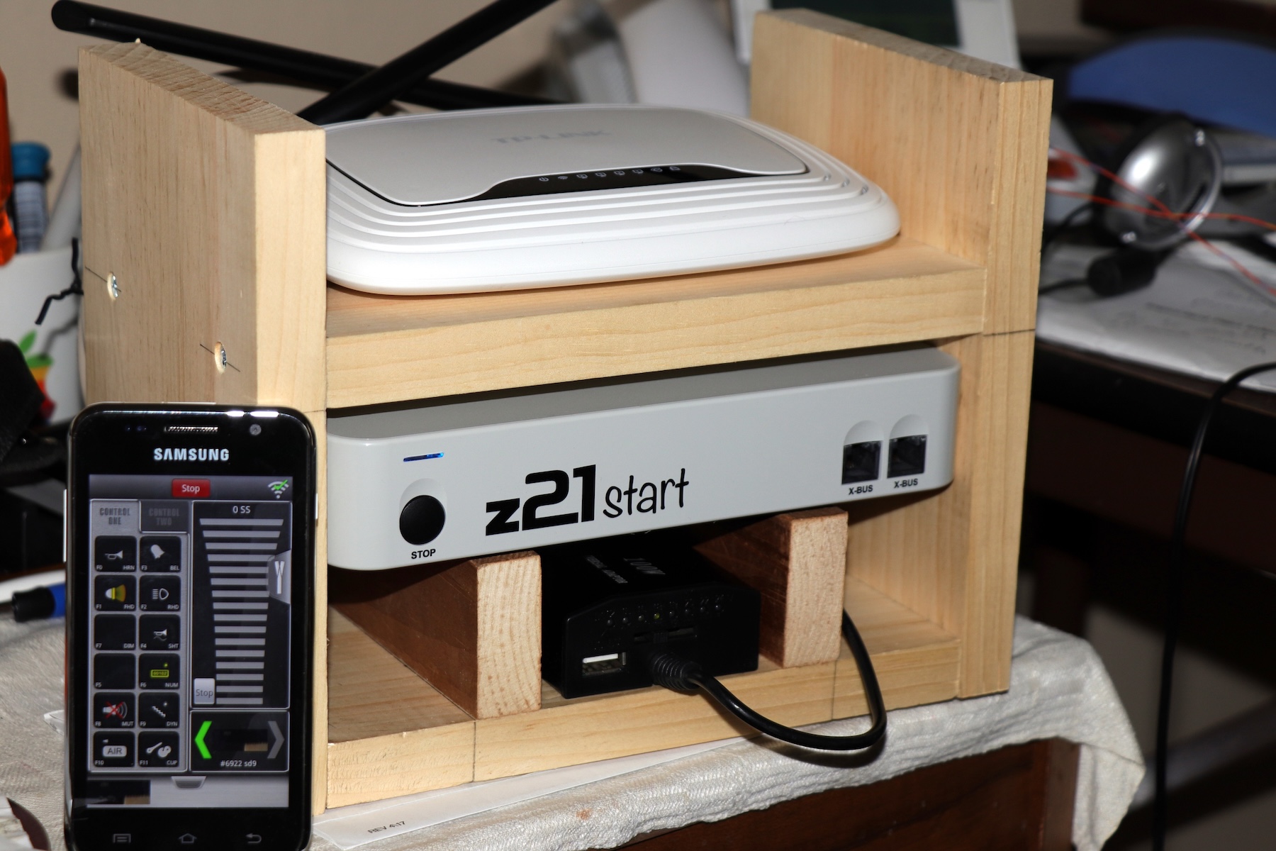

Then I discovered that in Europe the beginner/intermediate z21start (white box) could be found for sale at some dealers. So… I ordered the white box from Germany (about $125 shipped to USA, back then). I also picked up a separate power supply for it from an American supply house (didn’t really need that, the z21start came with a power brick that would have worked). I also bought the companion TP Link router set up for the z21 and wifi, which added another $45 or so.
Took a few weeks to get all this stuff at-hand, but it proved worth waiting for. I had it set up and running in very short order. I even built a small “cabinet” for it all to sit in:
I powered my small layout (a modified version of the MR “Black River Junction” plan) with the z21 setup for about 4 years, and then…
