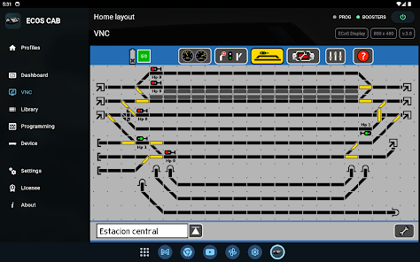

  8. Layout editor you can have a built in Panel indicating the layout and turnouts (See Pic)
In my opinion a best of both words, new features WIFI etc and still use existing throttles and power from Legacy hardware.
