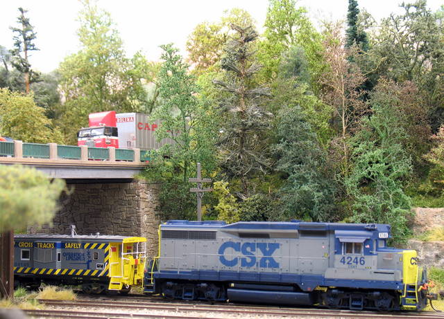

Speaking of cropping, this photo was done as a vertical, I cropped out the center part narrower than the original:
Taken with a 10MP Canon XTi, with a Tamron 11-18mm lens at 11mm and f/22.
Jon, I’ve always been a big admirer of your modeling skills and don’t see anything wrong with your photography either. It constantly amazes me what a lot of guys are doing with less than pro camera equipment!
