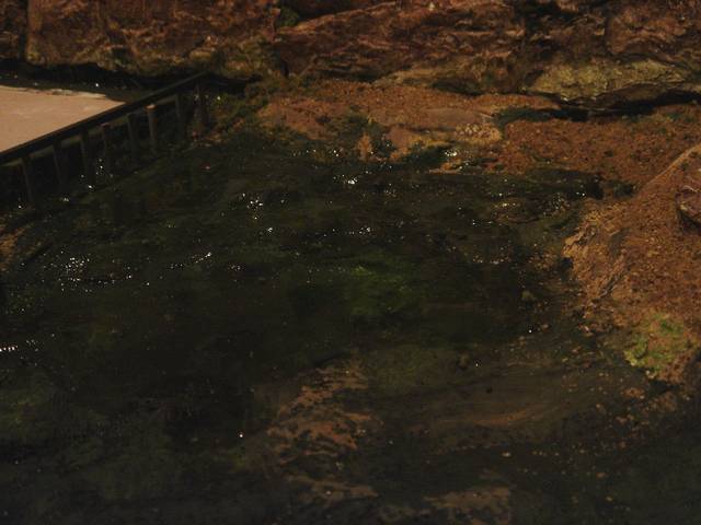

The trick with water is to get the illusion of depth without actually making something deep. My deepest water is no more than a half-inch, yet it looks much deeper. The first step is to paint the floor of the harbor in dark colors - black, dark green, dark blue, brown. As you get to the edge, taper off the dark colors and use lighter ones.

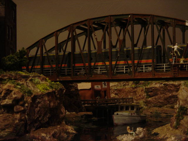

I like to use about 3 or 4 pours of Envirotex. I tint the lower layers with a bit of craft paint, just a drop or two. This gives the Envirotex a slightly murky look, and greatly adds to the illusion of depth. This is after 1 or 2 layers of Envirotex. Since you asked, there are pilings for the deck of a waterfront restaurant that the water is “flowing” around.
I use pink foam as my layout base, and I usually cover over water areas with plaster cloth, after gouging out the foam to get a sunken area with an irregular surface. I concentrate on painting the deeper parts black. Once the first layer of tinted Envirotex is poured, they are already become “deep” from the dark color and the unclear water. On subsequent layers, I use ligher tints, and I usually don’t tint the top layer at all.
The finished harbor looks deep, but it isn’t.
For me, I like Envirotex. Realistic Water tends to yellow over time. They both tend to creep up pilings, rocks and sea walls, but after it has cured you can always use Testers Dull Coat. Spray some in a little cup and brush it over everywhere it has crept up to. For salt water I like to paint my base a very dark blue, almost black. My harbor is 1/4" deep, and done with two pores
