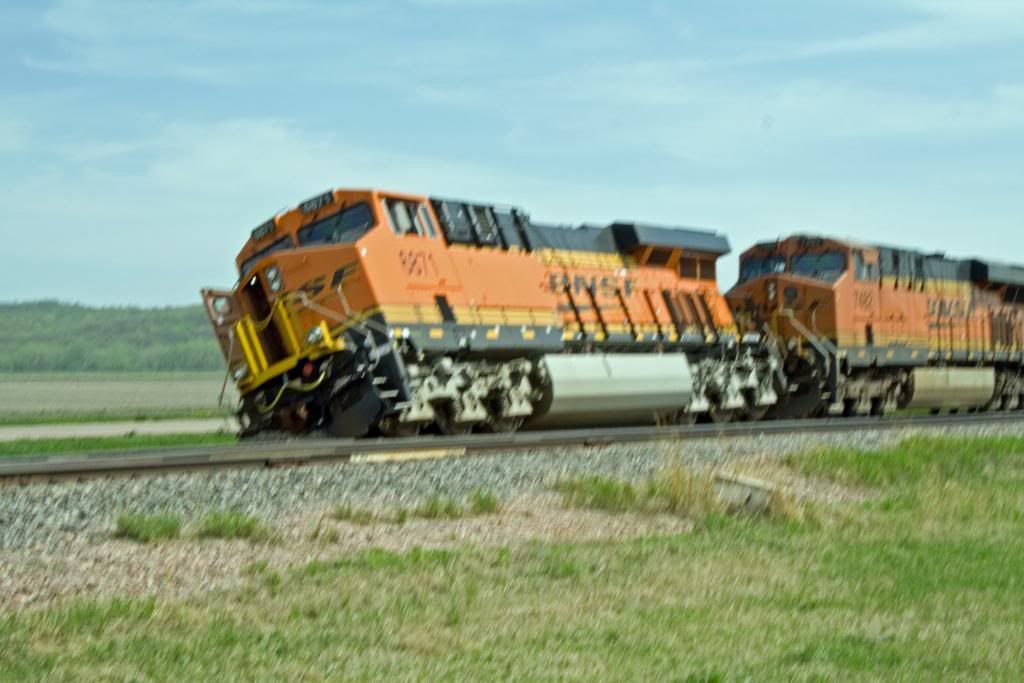

This is in mile 520 of the BNSF’s Aberdeen sub today:
If you look at the other side, it is apparent what happened. Just why is another matter.
It is a long siding which is frequently used to park trains for a crew change. Speeds on this siding are in the 10 mph range. The train was an empty grainer headed back north. The switch and the derailer are centrally controlled (presumably from Ft. Worth).

interesting, the second unit does not seem to have derailed, either the track department is at fault, or whomever last inspected the locomotive and did not see the bad flange.
The second unit not being on the ground would suggest that the crew is not at fault. Even at 4-5 mph shoving the unit that far into the dirt is pretty easy considering the loaded train!
Gravity works, the alligator certainly bit (Derail did what it was supposed to do) , the lead trucks on the second unit are down. It would appear that the second unit is not completetely over the derail.
Track department’s fault? Like Balt, I’d like to see what all the parameters here are, but it does look like one of the operating crews blew it.
LION thinks that the derail was located where the switch stand and the “D” indicator is located. That the “D” is facing the track shows that the track was blocked by the derail.
LION thinks that the derail was dislodged by the leading truck and seems to now be located at the leading edge of the fuel tank. LION thinks that the second truck on the lead locomotive derailed because the whole locomotive derailed and not because of the derail device which was destroyed when the first truck hit it.
And this is why, even though the second locomotive is past the derail stand, it did not derail.
LION may not be correct in his interpretation of the photograph, but you get what you paid for.

Athough I agree with the assessment that the reason the 2nd loco went past the derail location, but didn’t derail, is because the derail device was “removed” by the 1st loco; Semper still want my money back.
If it is a power derail, like mentioned in the original message, I would think it to be the split rail type. Looks like a switch but without the frog and a short section of track (ending short of where the frog would be) to better guide the equipment away from the main track. The second engine’s truck may just be at or slightly over it, making it look like it’s not derailed.

That’s quite an angle; I’m surprised it didn’t tip over.

The pictures don’t clearly show if the derailed equipment is clear of the fouling point with the Main. The defined purpose of derails on sidings or spurs is to keep the equipmet that gets derailed from fouling passing traffic on the Main Track and thus protecting the Main Track.

I’ve been out of town so I did not get to see who and how it was rerailed. All the trucks of the first engine and the leading truck of the 2nd engine were on the ground. Everything stopped short of the point where the main would have been fouled.
