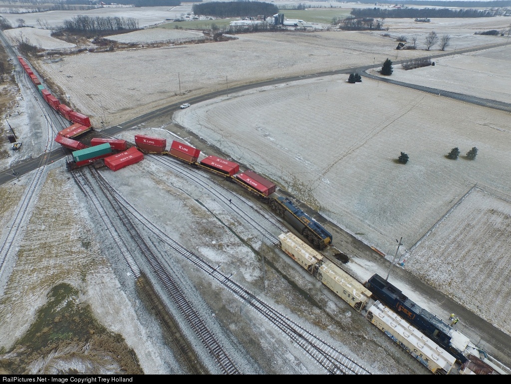

“MARYSVILLE, Ohio — A CSX train loaded with cargo boxes and bound for the Honda plant hit a stationary rail car on a track behind the Scotts Miracle-Gro chemical plant in Union County this morning, derailing 10 cars and an engine and injuring two CSX employees.”
Some photos on RP.net … Looks like a model railroad.
It took me a moment to realize what the “reporter” meant by “cargo boxes.” Apparently, the “reporter” knows nothing of containers. Also, I was trying to determine, from the pictures, what “railcar” was hit.
About 25 seconds in the video you can see the hopper car that was struck.
Sorry - photo and story don’t jive. What I see makes my skin crawl. CSX operating department probably going nucking futs right now.
When the real story surfaces, let us know.

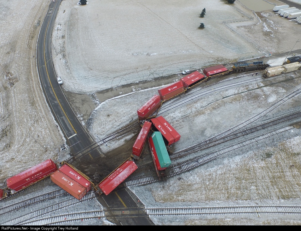

The ol’ speculator says that it was pretty obvious from the aerial view that the train crew wasn’t expecting to “take spur” here.

Bottom photo, right side, two road units, lead unit cut away…the hopper is crunched up in front of that locomotive.
It looks like someone forgot to line the main back for the main, the switch is just on the far side of the road…the train looks like it was routed into a small holding yard or siding.
