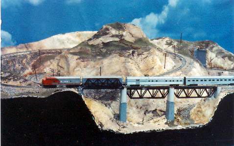

Quick and dirty “desert” layout thrown together in about 10 days some 35 years ago as a demonstration for N scale. Industrial-paper-towel and Hydrocal(r) hard-shell with Linn Westcott’s zip texturing over it. And Kitty-Litter(r) for the rock rubble.
