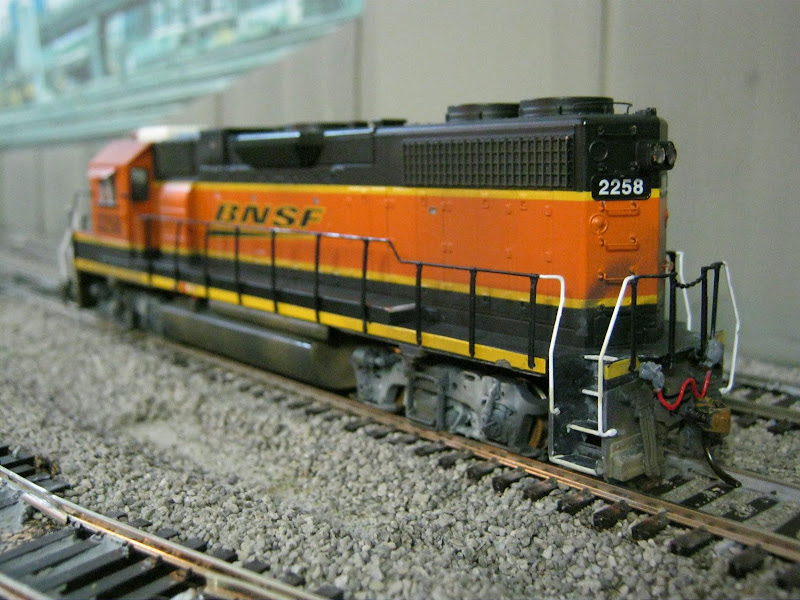

Well you guys told me I needed an airbrush. So I got the Paasche HS-SET. Been playing with it, getting familiar with it the last few days. Decided to go for it on a loco.
This is an Athearn RTR GP38-2 that I just had someone install a Tsunami and LED lights. It sounds awesome! Picked up some details west parts, this thing didn’t even come with a plow.
Let me know how I did?

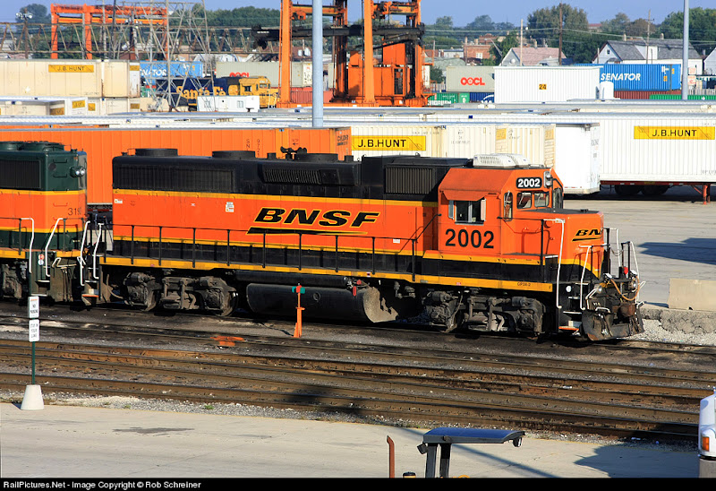

And this is the prototype look I was shooting for:

Nice job. However, the B-B trucks indicate is a GP38-2 as opposed to an SD38-2.
Nice first try with an airbrush, Mike. My suggestions for further minor adjustments would include:
  1. More road dirt on the trucks (diluted Floquil Rail Brown) to tone down some of that very light-colored brake dust.
  2. The upper, angled, surfaces of the car body remains too reflective - they should be dead flat, rather than producing highlights - so more light applications of Dullcote are needed there.
  3. The white A/C box on the cab roof should be weather-darkened just slightly. It appears stark white in the proto image only due to contrast (unless it was added yesterday!).
  4. The air vents and intakes need to stand out just a little more in contrast to the body. Since the body color there is already black, mask these and apply a very dark grey lightly to make them “pop out”. Probably do the same with the fans on the roof.

Thanks for the feeback.
The photos don’t seem to do it justice, it looks better in good light.
I used Weathered Black on the all the vents, you just can’t see it.
I didn’t want to take off the shell because I just had the decoder & speaker installed. So I masked off the shell and airbrushed the tank and bottom using Rail Brown.
In the prototype photo, you can see that the winter hatch is fairly new looking. I’ll shoot it with some weathered black just a touch to tone it done just a bit though.
I’ll probably shoot it with some dullcoat as well.

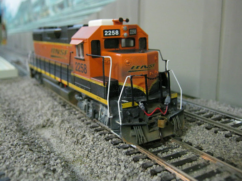

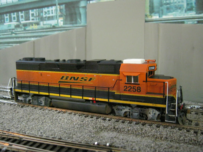

OK I just made some adjustments, let me know does it look better now?
Wonderful work there! Keep up the good work!
Very impressive for a first attempt, the only thing left I see is that shiny Kadee brake “hose”, maybe you could give it a light dusting to match the plow?
Nice job, can I send you a couple of steamers? [swg]
Nice job, I believe you’ve nailed it the second time. mh.
Thanks. Yes I agree, need to paint the brake hose now.
