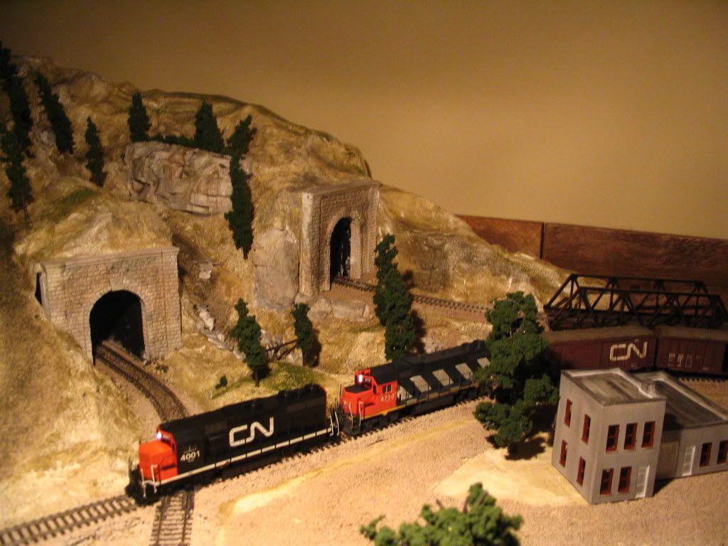

What is the best way to break in my Athearn GP38? Fast, slow,constant speed, variable, load, no load?? or does it really matter. I just got mine last night and ran it for about 20-30min total. It makes a racheting/klicking noise, mostly in the curves, but is already getting noticably quietter. I read this is normal? When can you tell when its time to lube the gears? I understand that using Dextron ATF is a good choice? Is there any thing else to do? Does anyone have a link to a sight for maintenence?

looks nice
