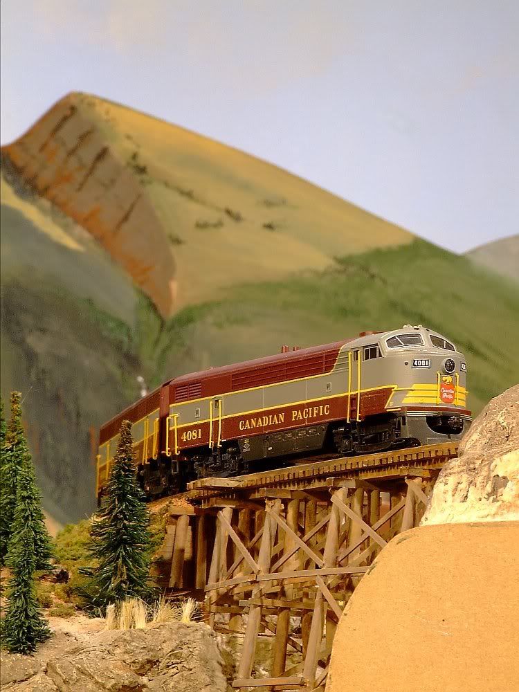

I have a 5-bulb swag lamp on a chain that I lower from the cieling to light the area that I will be photographing. That’s how I made the shot below…

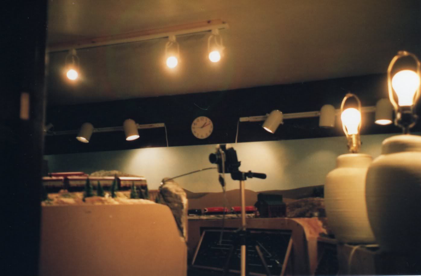

I know this isn’t the best photo, but it gives you a fair idea of what I use. Now that you’ve got the white balance figured out…
I have a fair amount of halogen track lighting that I aim towards what I’m taking a photo of. At locations where the lights can’t light it on all sides, I bring in some table lamps from ‘upstairs’.
The pictures usually turn out well. Below are an old one and a new one of similar composition, and almost the exact same lighting, with a few variables in equiptment, but as you can see, the lighting is very good for all of them.
