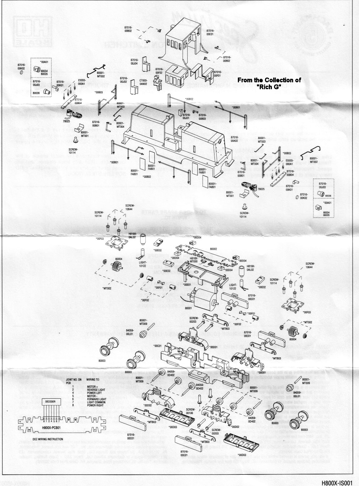

My 44 tonners have the bulb in a metal tube. Looks like aluminum.
http://www.hoseeker.net/assemblyexplosionbachmann/bachmannspectrum44%20tonpg2.jpg
http://estore.bachmanntrains.com/index.php?main_page=popup_image&pID=1397
The latest ones have LED’s on the PC board though it is DCC on board. No idea if Bachmann sells it DCC ready anymore. catalog does not show DCC ready.
http://www.bachmanntrains.com/home-usa/dwg/dwgs/62201.pdf
