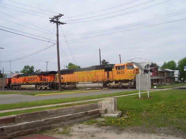

As a example here is a BNSF unit consist on NS at Bucyrus(Oh)…
