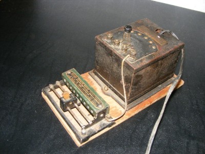

If you want to go “low-tech”, you could use a prewar Lionel rheostat. There are several almost identical models. They’re meant for mounting on a panel; but they’re only 5 x 2.5 x 1.5 inches and could easily be held. You would need only a 2-conductor cable, perhaps heavy zip cord. Here’s one connected to an old transformer:
Bob…That doesn’t look like it has recieved a U.L. (Underwriters Laboratory) seal of approval. [:O]
From the 1929 catalog:
No. 81 Controlling Rheostat–With this rheostat you can, when using dry or storage batteries, operate Lionel trains at various speeds, or stop and start them at any distance from the track. This is done by sliding the lever from side to side, or manipulating it up and down. This rheostat can also be used with Lionel ‘Multivolt’ Transformers when a gradual increase or decrease of current is desired, without touching the lever on the transformer. The porcelain coil of this rheostat is protected by a perforated steel cover, and air holes prevent overheating. Size 4 7/8 inches long, 2 1/2 inches wide.”
No more dangerous than the track itself!

I was actually serious about suggesting the rheostat. There’s nothing dangerous about it; it’s small, cheap, and dirt simple, and an elegant solution to the problem in my opinion.

The rheostat does not require a powermaster…:wink:
