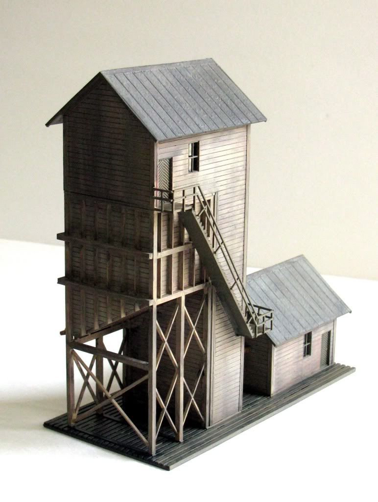

I make these dark brown plastic coaling towers look like well worn wood structures with a base coat of light tan (Pollyscale Earth) and then use india ink washes and other colors for more detail specific areas like rust and soot. It is only good for structures as you wouldn’t want to have to reletter rolling stock after painting it. Just a suggestion for structures.
  • Bob

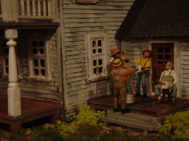

This is a relatively cheap kit called “Aunt Millie’s House:”
The effect is achieved with cheap acrylic craft paints by dry-brushing. I wanted an old, worn-out paint look.
I’m also an advocate of “distraction.” The figures and details draw the eye away from the walls, which are good enough as a background, but don’t come up to Harold’s level of wood modeling above. As always, he sets the gold standard in getting plastic to look like wood.

That is beautiful Bob…I haven’t started using any plastic kits yet, but when I do I hope I can make mine as good looking as that tower!
