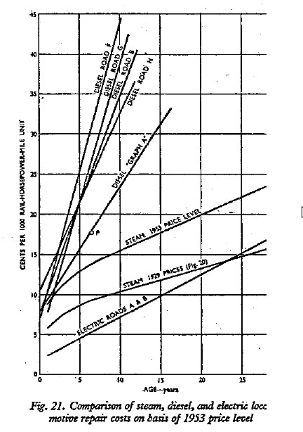

Well, that’s a formidible project. Excel is an excellent modeling tool for this kind of project. The difficult part of fleet comparisons is … finding comparable fleets. The average steam engine as of 1950 was 27 years old. The average diesel locomotive as of 1960 was about 8 years old. Overall diesel maintenance costs sure looked good. Even today, the average BNSF diesel fleet is about 15 years old. There has never been and probably never will be, in fleet terms, an average age comparable to the average age of steam engines at their heighth. That is a problem for any econometric comparison until you generate an age/cost curve for the respective motive power types. Those curves have been generated and are available. Too, as shops were modernized during the 1950s, that process improved the productivity of maintenance facilities and, while that no doubt benefitted the appearance of diesel fleet maintenance costs, it has to be segregated out as a factor, and that is hard to do without some very careful analytical work.
There are some detailed studies out there done by competent and experienced engineers and subject to peer review. Thomas Thelander did one for Swedish railways in the early 1960s and H.F. Brown did one for British Rail in 1960. Brown’s was published by the Journal of the Institution of Mechanical Engineers and is available at their website. I believe Thelander’s was also published there, but my copy of his paper is in storage and I don’t have it for reference.

Probably so, but that raises the question about what the diesel maintenance curve looks like “down the road”. Too, the maintenance costs of steam are problematic during that period as the fleet was being allowed to age without an eye to sustaining that fleet. And there were still substantial numbers of locomotives built prior to 1915, built with old technologies and old metallurgical knowledge and skills. As you may note from the graph posted above, the differing technologies age quite differently in terms of maintenance requirements – and the highly complex machine “ages” substantially more rapidly than the simpler technologies of whatever type. That shouldn’t be a surprise … but the rail industry is unique in many of its perceptions.
Even for someone as careful and knowledeable as H.F. Brown at Gibbs & Hill, it was a difficult endeavor to extract meaningful data and, as Brown pointed out, even his evaluation measured, ultimately, the practical results of the last design, a “modern” steam engine, for which there was a large scale application and data – the Northern – which supplied the data for comparison to diesel-electric fleets designed and built in the 1950s; and being marketed by the claim that they, in turn, were so much better than the diesel-electric designs coming out of WWII.
They probably were – so would a steam engine fleet built in the mid-to-late 50s.
But, you go with the data you have, not the data you wish you had.
In this case, any comparison, no matter how carefully done, necessarily compares the two technologies across a generation gap in design and manufacture which necessarily operates automatically in favor of one o

Just for the sake of completeness and copyright attribution, and in case I am intriqued enough to pursue this information, could you cite the source of this image?
Thanks…
David Pfeiffer
Oops, must have cut off the bottom of the image when I photoshopped it to reduce the image size. The attribution there reads “from H. F. Brown, “Economic Results of Diesel Electric Motive Power on the Railways of the United States of America,” Proceedings of the Institution of Mechanical Engineers, 175:5 (1961).”

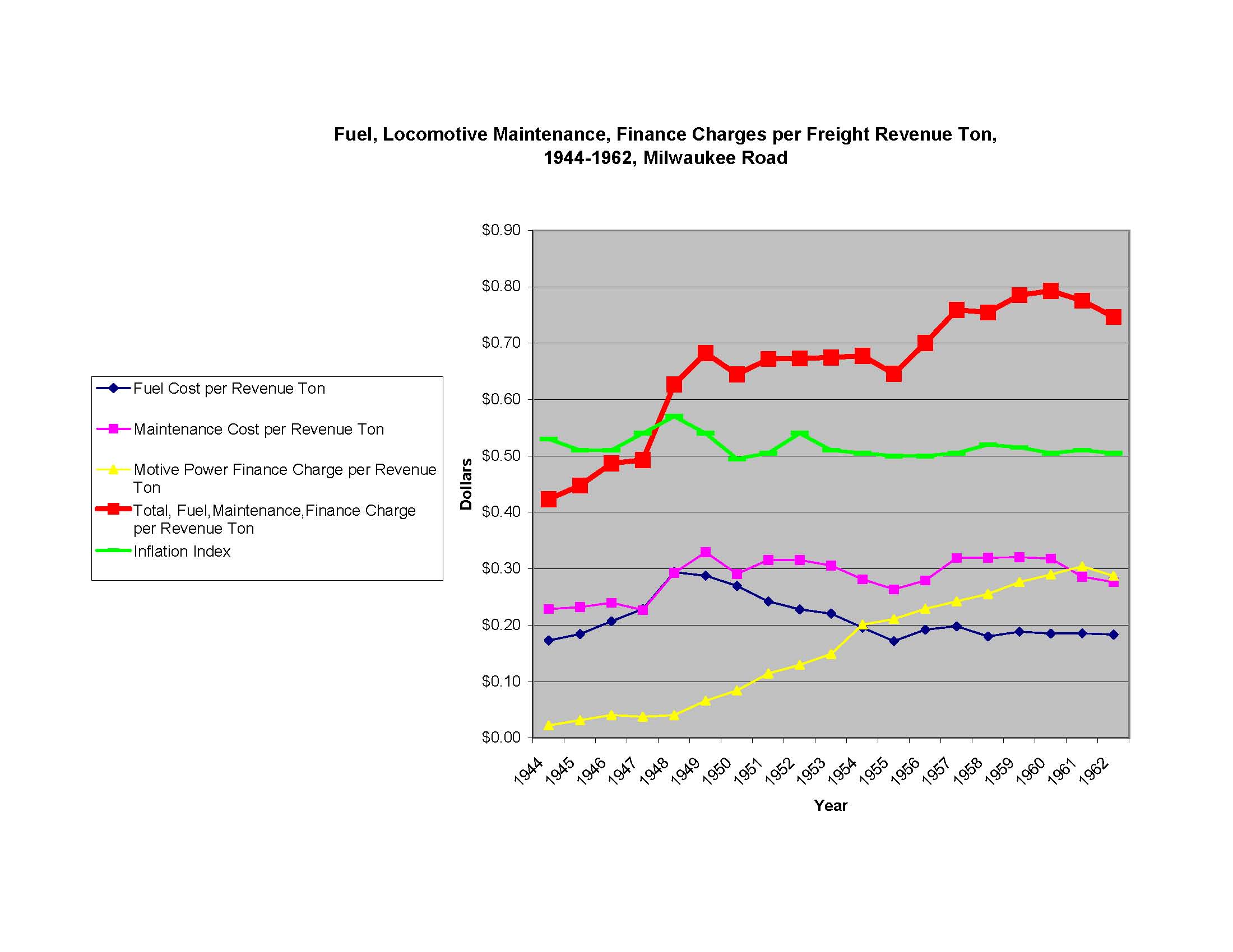

but the blog has been updated. I have started an actual model based on data one of you gave me (i forget who…but please take credit if you wish). The blog can be viewed here, it explains the update, and provides a link to the file: http://steamvsdiesel.blogspot.com/
Comments/Suggestions are highly appreciated, either here or on the blog.
  • Peter
I just saw the spreadsheet, and it looks pretty good; you’re on the right track (pardon the pun).
Two observations:
  1. tonnage and carloads declined substantially during the era of dieselization. If railroads had stayed with steam, the decline in needs would have permitted railroads to scrap older models and gain the fleet efficiencies shown by newer models. As of 1950, 40% of the existing steam had been built before 1915. Had the diesel-electric been the primary motive power, as a hypothetical, the same statistical result would occur as a result of being able to retire older, high maintenance items. Also, train crew manpower needs declined as a result of declining tonnage.
  2. You have a conclusion about diesel fuel costs in your text, but I don’t see any comparison with costs of coal on a comparable basis during the time frame in question.
The whole point of Dieselization, of course, was to purchase a more efficient motive power fleet. What was missing from most of the public relations promotionals was the key part of the process: “purchase,” – and because the economic service life of the machine being purchased was considerably shorter than equivalent steam, those studies that took the time to look at the financing implications of the changeover found that, for road power, the additional financing charges exceeded the cost savings obtained from efficiency gains in operation. This showed up very clearly at Milwaukee Road:
