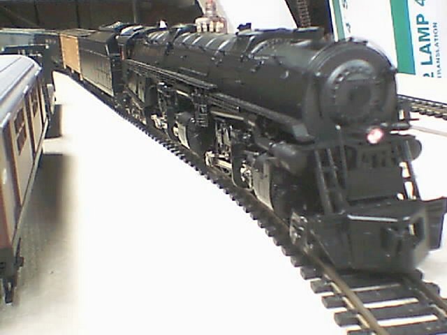

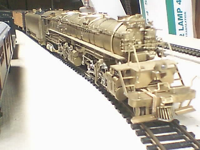

Now guess what I do next, I grabbed my DM&IR 2-8-8-4. Laid it on the straight part, and started it into the 22" radius curve…soorrrry, AKANE DM&IR 2-8-8-4’s dont like them curves. Well, sometime I will lay down a 24" and 26" and maybe 28" loop for testing. I have a South Shore NWSL little joe which says minimum 26", tho I might test it on 22", no guarantees…
sooo after this, put away the 2-8-8-4, switched power supplies to the BachMann EZDCC, I put my BLI 2-6-6-4 on. Whoosh, Wheeeerrrr, its alive, ITS ALIVE!!! Whata sound system…
It got around the loop fine, but then, whats this? The pony truck is off. There is one spot I already knew where a curve is on between modules and their not an even fit, a slight hill.
The pony truck was on the curve and the inside wheel was lifting off, and when it got to the straight, the pony truck couldnt correct and off it goes.
I threw an outside guard rail at the derail point but that didnt help.
So I turned the engine upside down and looked. I didnt think the pony truck has enought “play” room to manipulate. So I pop the cover off, man they had those mini-screws tight!!
On the pony truck they had a spring thing pressing down, I bent it to make it have more pressure downward, then I filed part of its swing restricting material off so it could turn further. Put it back together and it ran better over the “hill” spot. Not perfect

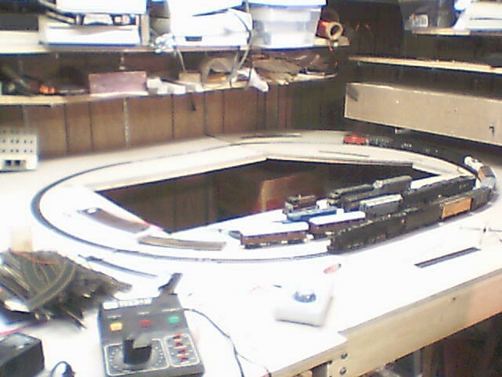

Theres the silly circle. What, got all this up in like 2-3 days?
The screamin BLI 2-6-6-4, bought it before they had the sound legal prob. a few years old already. It got its first real excersize today.

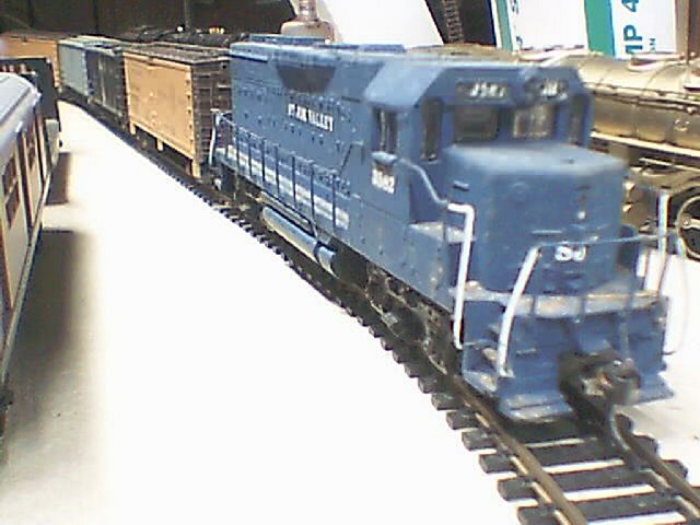

The initial groundbreaker loco, SJV GP35. It has interior and working 1.5v constant lighting all over the place, but my DCC DC test on it blew them…

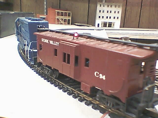

SJV caboose, marker light LED’s, works in both directions directional on DC. pre DCC stuff here…
