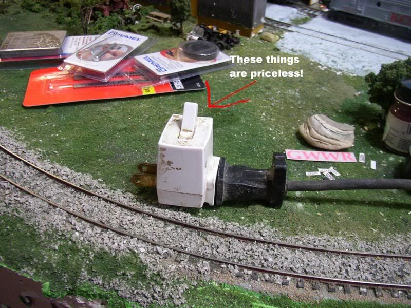

Thanks for sharing your story Karl. I sure hope the hand will come back to near where it was. All things considered I suppose one could say you were “lucky”, it could have been worse but judging by the pictures, you sure didn’t look lucky. I have had occurences with my Dremel’s power switch as well. The switch is in good condition but I have had it click back on, (though not at full power) when I set it down on the bench to perform low rev acrobatics! This is an issue we should all be aware of when using a Dremel or similar power cutting/grinding tool. I like Jeffrey’s idea of using a switched receptacle for the dremel tool. In fact, I think a foot operated switched receptacle might be a wise safety feature to add to the work bench.

Here’s a photo of the outlet switch I use with my Dremel. The text in the pic says it all.
