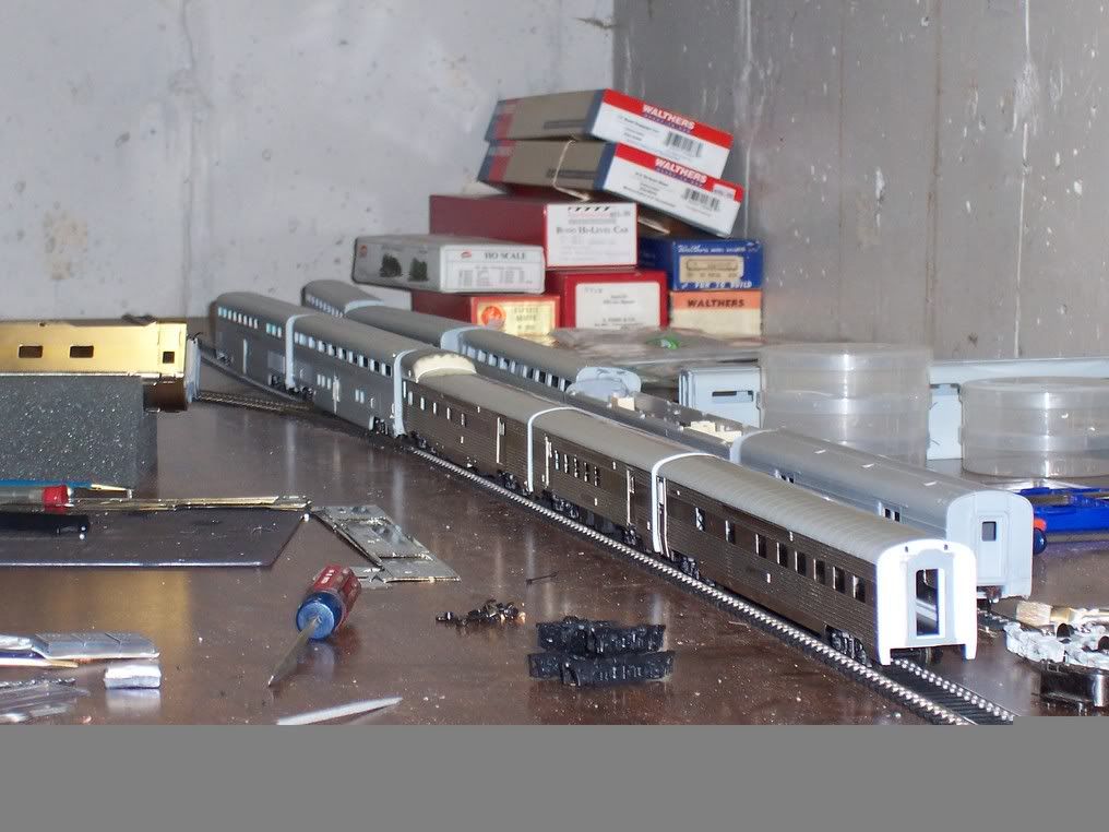

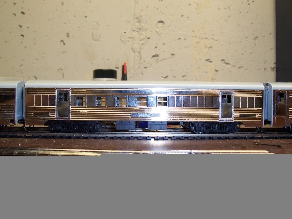

I have seen the high speed, resharpened bits on eBay and wondered if anyone out there has experience with them. More specifically, will they get through brass. I posted pics of the patient/victim below. Thanks

I just need to drill some holes for grabs and bag catchers. I have had some trouble getting 79/80 bits through with a pin vise, even with wax. These sides are supposed to be pre cored, but obviously that didn’t happen. I have had quite a bit of experience with the sides, but everything I have had to deal with has been drilled already.
