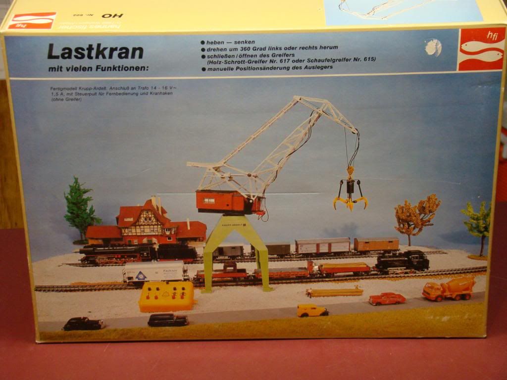

I have a HANNES FISCHER Stationary Crane #602 - looks like a Roco 40110 (DC), but before the DCC.
I am looking to see what transformer(12-16volt, 1.5 amp) fits the plug-in pins and what the color codes are?
Will have some pics by weekend

Have pics now and my Tramp arrived

Anyone know what I need too power this - Marklin 6627 transformer? Thanks
Hi,
found another version of it on Ebay from France and it had a picture of what it can do and the power requirements. It said that it requires 14 to 16 volt AC and draws up to 1.5 amp.
Hope it helps
Frank

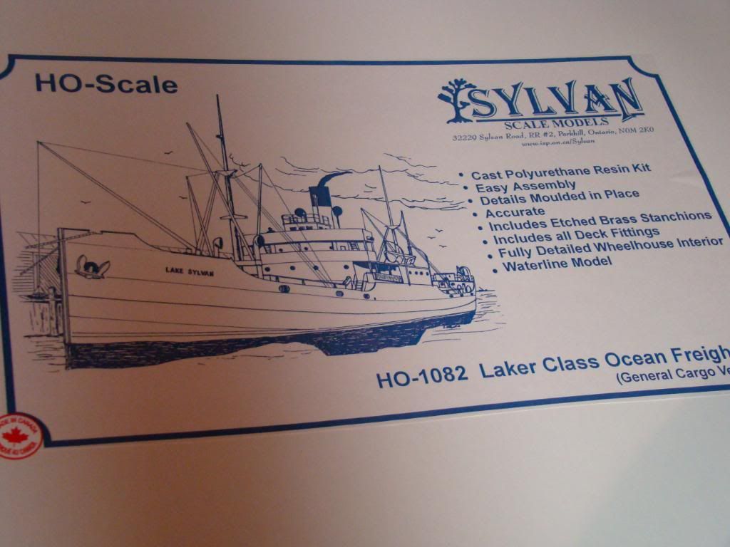

Walther’s tugs and carfloats, plus coal barges, and Sylvan Great Lake and ore freighters on movable tables.

Would this “do” to power the crane?
Amseco® XR-1650LED Transformer
For use with Kadee® #309 & #810 Electric Uncouplers, Lighting, Motors, Stitches, Accessories, Etc.
INPUT: 120VAC 6Hz 0.50A
OUTPUT: 16.5VAC 50VA
UL listed E82475 3T74
#166 Plug-in Transformer XR-1650LED
Hi,
yes I would use it to power the crane. It is AC, and has a capacity of 50VA/16.5VAC=3 amp. Plenty of power for the crane.
Hope it helps
Frank
Many Thanks - Now - Which color wire to where? I think they are red and blue? Will look after work…
Is it like house wire? black-hot,white neutral?
