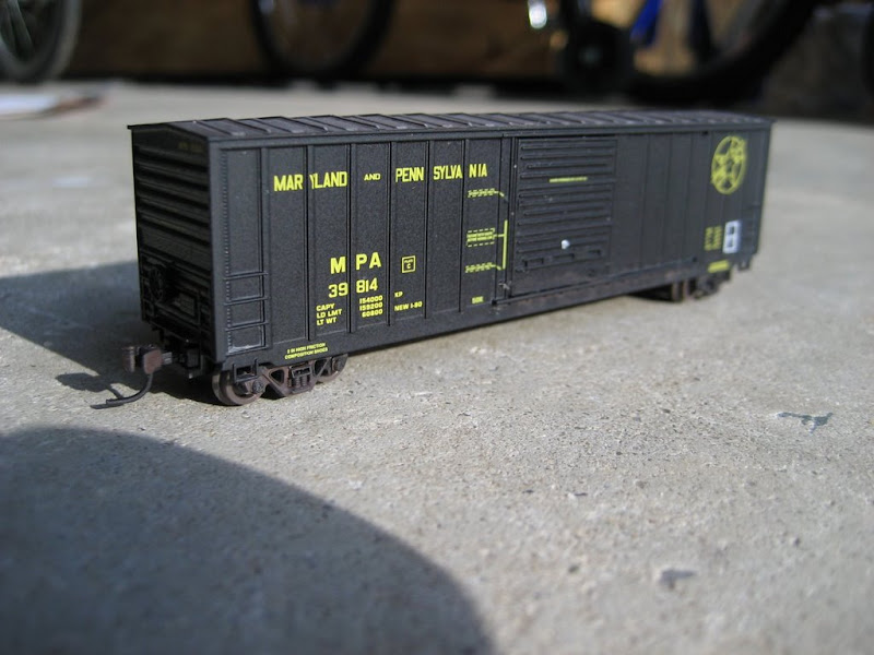

The Maryland and Pennsylvania boxcar has a built date of 1/80, so is 6 months old in my era. Photos confirm that in 1980 these cars were still immaculate:
So, all I did was paint the trucks and couplers with Burnt Umber. I thinned the Burnt Umber and then added a slight hint of rust below the door track. A touch of Burnt Sienna on the knuckles of the couplers suggests fresh rust. Then a very, very, very thin wash of the River Rock… Very light. Then wiped off before dry. The roof got one very, very thin wash of Burnt Sienna, wiped off and one coat of extremely thinned black, allowed to dry. Car was then Dullcoted.
The result is a boxcar that looks new, but has taken a trip or two down the line.

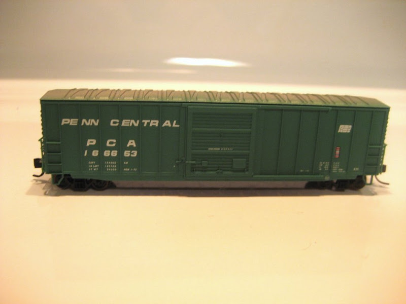

Now the fun begins. PCA X71 #166653 was built in early 1972, and so is 8 years old on my layout. So we can be dirty.
The first thing to do is to add the ACI decals and seal them with Dullcote. Photos show the ACI labels below the PC “worms” logo on the right side:
So, that was the easy part. Up next is the weathering. I used several washes of a Burnt Umber and Black mixture on the sides, wiping off between layers. Oh, by the way, the great thing about craft paints is that they don’t become permanent until you seal them with Dullcote. Don’t like it? Just wash it off with a wet, clean brush!
The roof gets 5-10 coats of much thinned Burnt Umber/Black wash, with 1-2 layers of a much thinned Burnt Sienna wash. I let these coats sit and dry rather than wiping them. The result is a fairly rusty roof, but not a complete rust bucket. Once again, Burnt Umber on trucks and couplers. Seal the car with Dullcoat.
