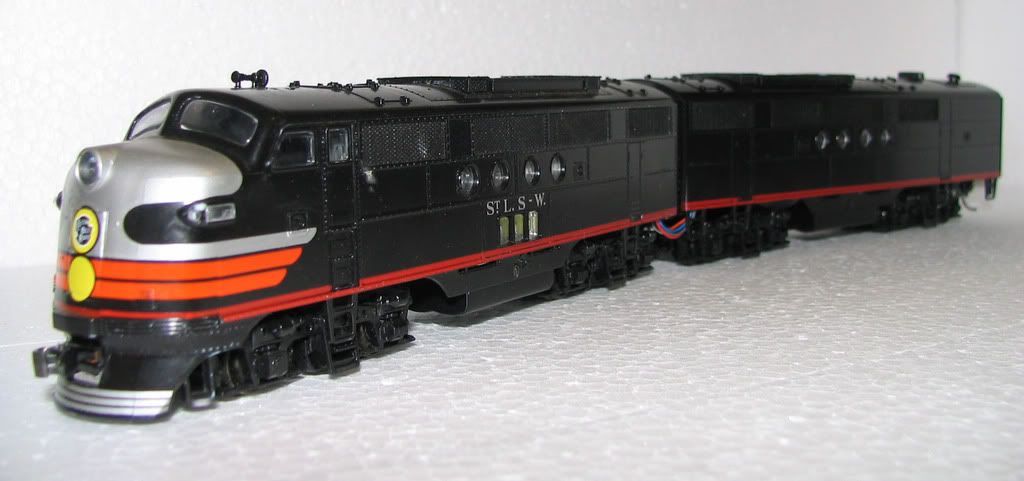

EXAMPLE 1
This little set is still available from Bowser/Stewart, but at $185 w/o sound I prefer my $50 DCC ready Ebay set…even had LED headlight. Thought I would try something different as this is a drawbar connection, so I didn’t bother trying to fit even the Soundtraxx decoder in the A unit…just put it on top of a the enclosure for a pair of large oval speakers in the dummy B Unit. Making space here was easly. The connecting decoder wires are not too noticeable, and I will colour them all black later. The wires sit nicely in a groove under each shell, so are not getting pinched at all. Just had to run 5 wires as there is no backup light and the speaker wires stay in the B unit.
The sound with large ovals, is very very good.
The A unit kept shorting out on every switch however. Thought something was up with the pickups,so I wired the dummy unit trucks as well. Still no good. Finally, realized the A unit wheels must be out of whack…sure enough, they were all far to narrowly set. Runs fine now.
Never had a unit with side mounted LEDs. What is that all about?
See, I broke off a horn and lost it. That’ll cost me. I also have to add a road number now that I know which ones SSW used.

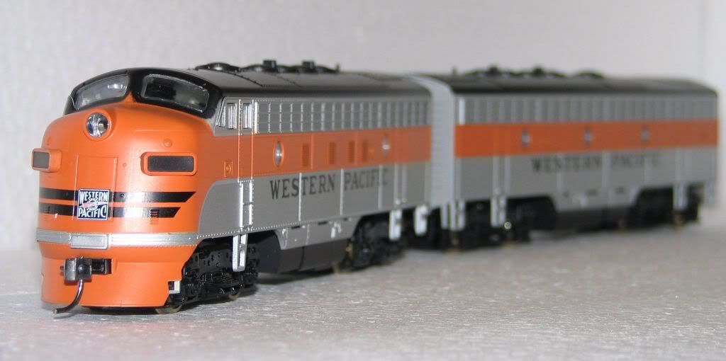

EXAMPLE 2
No real saga here. Just a good price for t
