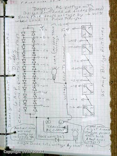

A potentiometer is a current limiting device, the voltage drop will vary with the load, so this is really the wrong device for your application… and they are large and expensive at 50 watts & 10 ohms, and waste a lot of energy in heat.
For supplying multiple voltages to various points from a single large transformer, you should consider a diode array with several taps.

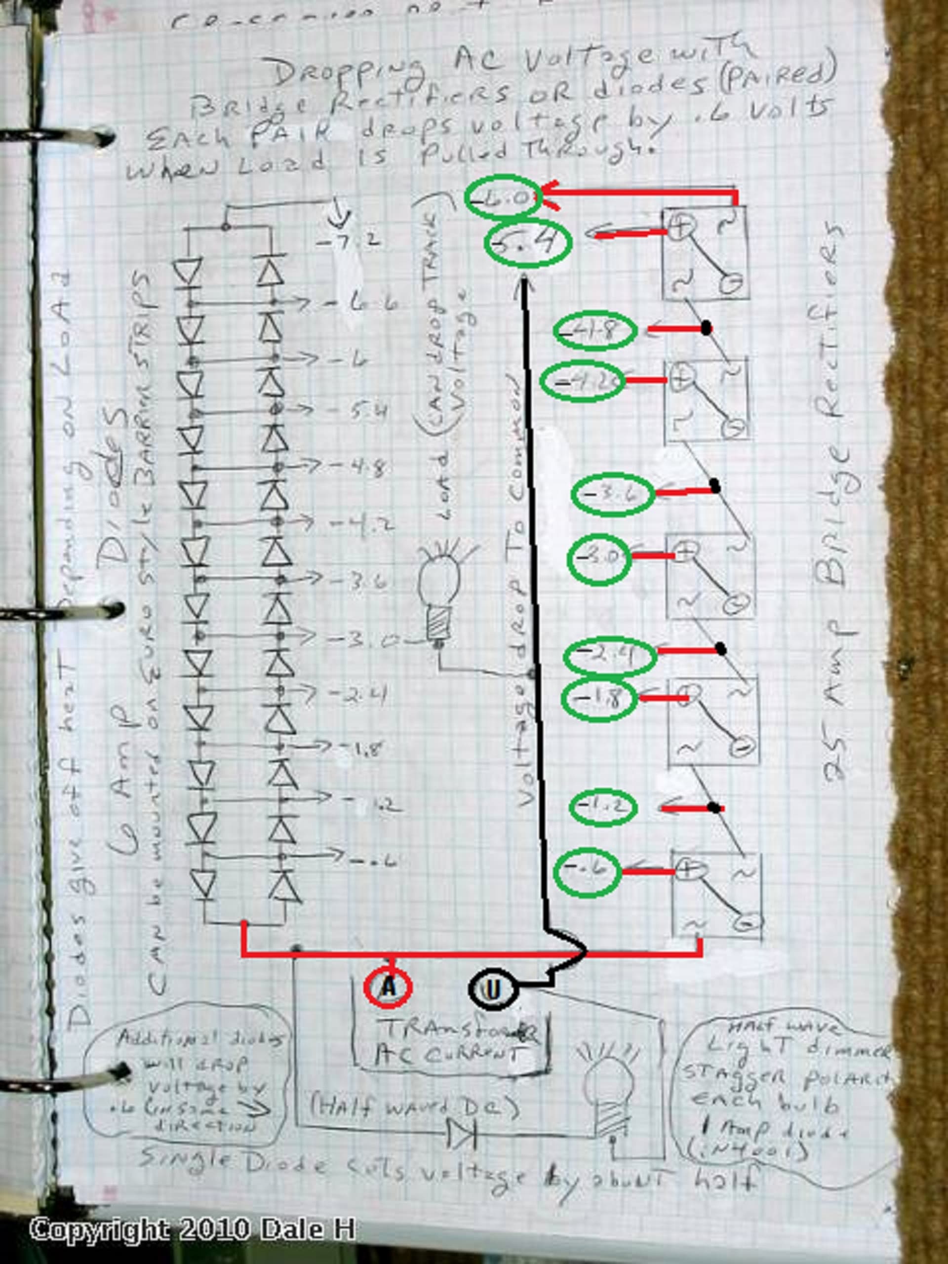

Here is the complete article:
Hi Rob
Thank you for the information. I already purchased all of the potentiometers that I need, so I will continue with them.
Your information looks intriguing since I have never built anything like that before. Once I have my layout operational I will look at replacing the potentiometers with the diode array.
I appreciate your help.

Super post Rob. Thanks regards mike endmrw0520261348
That would be my thing too, if I were doing this, but it is convenient to vary voltage in real-time with a dial–maybe hook up a rotary switch to the diode array?
ā€œVarying AC voltage in realtimeā€ is going to involve a Variac, not a rheostat or ā€˜potentiometer’ unless you rate the resistance to carry the corresponding current. The point of using a diode ladder instead of a resistance ladder for power loads is the waste heat.
There actually are relatively budget-priced variable transformers for sale,and in some respects it may not matter if parts of them are Temu quality. I’d still recommend voltage-to-voltage conversion for DC even if it costs a little more to do it right.
