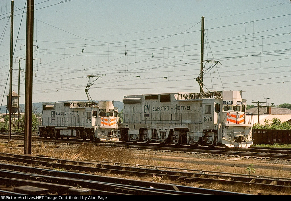

Perhaps the most famous ‘regular’ EMD electrics (leaving out the Rc-4-derivative AEM-7s) were the pair of demonstrators built in the mid-'70s: GM6C #1975 and GM10B #1976. As noted, these used ASEA traction gear (at that time European components were very exotic!). There wasn’t much call for modern freight electrics at the time, and PC/Conrail weren’t particularly in the market – essentially the only market in the United States – for new freight-only locomotives (if anything, they already had a glut of GG1s, E-44s and E33s, etc., and they were already running extensive diesel consists on the wired trackage because it was more flexible to do so)
I dimly remember that the GM10B had some kind of running-gear difficulties, and the 6C was not particularly kind to the track… certainly wasn’t as good as the decades-older G in that respect. We didn’t particularly like the appearance of the locomotives at the time (call us spoiled by Loewy streamlining!)

The GM10B and GM6C were gawdawfull heavy rascals…At low speed they “crabbed” pretty good…saw both go through La Junta, CO en-route to AAR/TTC’s Pueblo Test Track (then found out my camera had shutter problems, underexposed!)…

The GM10B rode on three, two axle trucks of blolsterless design similar to those on the AEM7s. EMD built them for two reasons I can recall. First, is the GG1s were getting old and in need of replacement. Second, part of the legislation creating Conrail called for a study of electifying all the way to Pittsburgh (I have a copy of that study squirrelled away, somewhere…). So, EMD had a potential market to sell into, if the electrification came to pass. What actually happened was that Conrail decided that better overall utilization could be had if they canned the electrics and ran diesels instead. And, the study didn’t show much of a rate of return for electrification, so the EMD electrics became orphans.

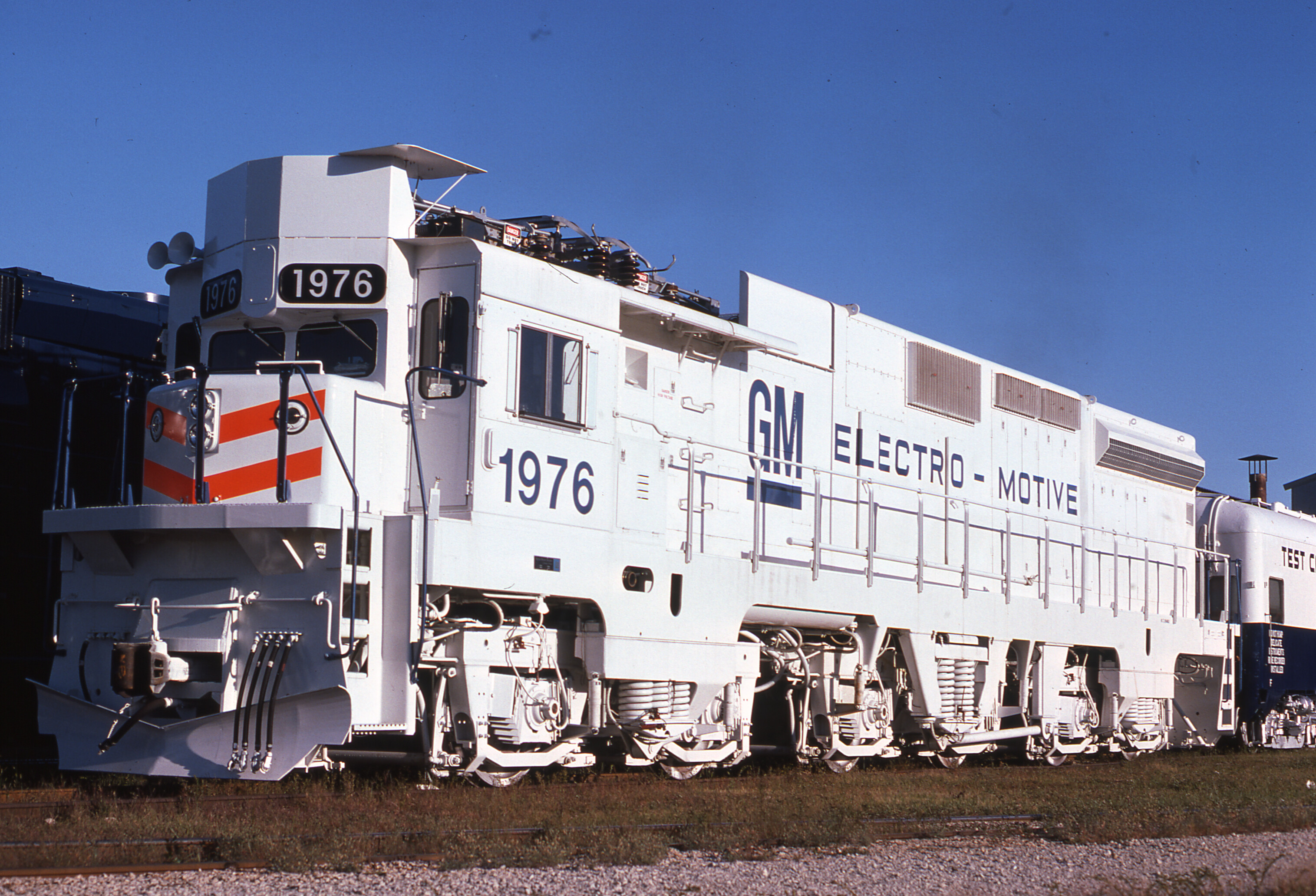

The GM10B could be considered as 1.5 AEM-7’s with different gearing and cab.
I’m glad at least something successful came from the two demonstrators, being the AEM7 tech. I’ve read up on some pretty contradictory experiences with these locos describing how they ran, some sources state the GM10B in particular rode remarkably smooth on poor trackage with its 3 bogies while others mention it rode quite roughly. B-B-B is very rare in North America anyways. It’s all fascinating stuff!

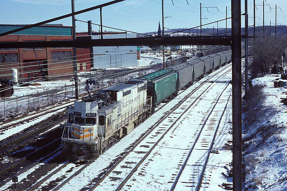

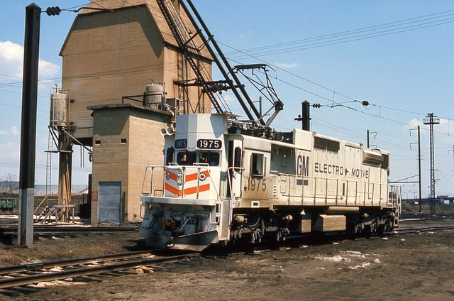

One of two EMD electric freight demonstrators trialed on the Northeast Corridor beginning from 1975, EMDX 1975 (GM6C) was the smaller of the two, rated at 6,000 HP and built on a SD40-2 frame.
Source:reddit
That’s only one GM6C. That was the el cheapo alternative, sharing the DC traction motors and other components of the SD40-2 to reduce overall expense. One sees this strategy much more rigorously described in the Garrett ‘dual-mode-lite’ research that followed a few years later.
The GM10B, the other ‘white wonder’, was far more technologically sophisticated. This involved much more technology transfer from ASEA; unlike the AEM-7s these were AC motors and drive, and while the outer truck pivoting arrangement on long secondary springs was similar to that on the passenger motors, the actual truck design was very different (perhaps Dave Goding has specific distinctive competence on the details).
