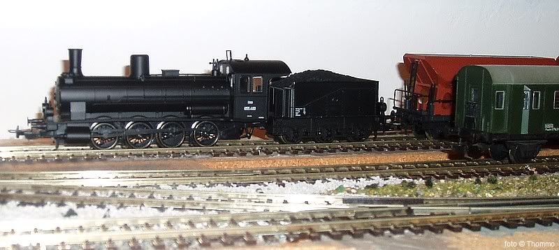

A recently joined club member is thinking of buying a European style steam loco, such as a Swiss 2-10-0 available from Roco, to head up his rolling European stock when running on the club layout (Digitrax DCC system).
What are the issues about equipping Roco, Piko and Trix locos to run with DCC?
There should be no issues. We use DCC here in Europe also.
The loco in question comes DCC ready, but unlike in the US, this does not necessarily mean that you can just plug in a decoder and off you go. It could mean, that there is just a soldering pad, to which you have to solder the decoder.
Btw, a nice looking loco!
