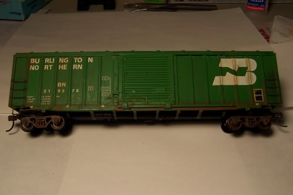

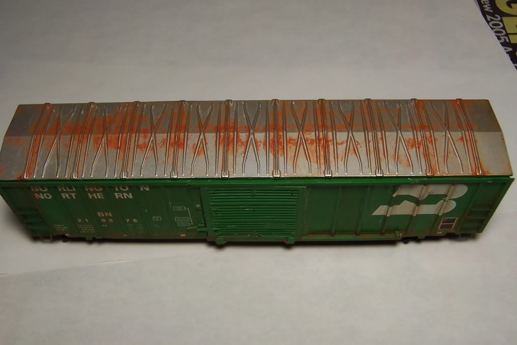

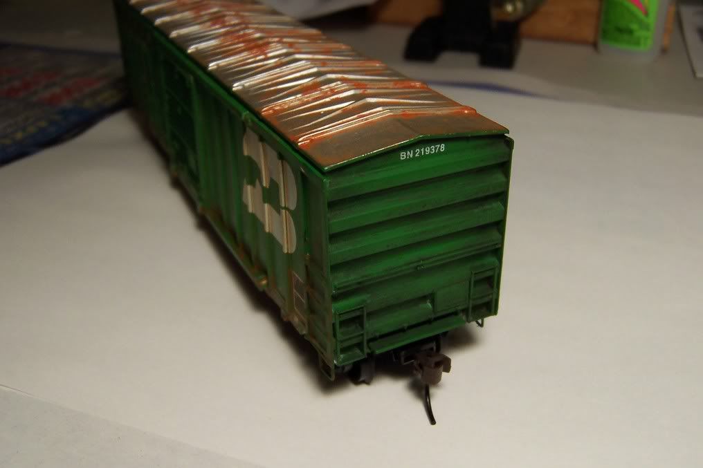

Only this time no eraser was used. My victim this time is an Athearn BN 50’ boxcar. I shaved off the stirrups (2 were already broken off) and the grab irons on the sides. I bent .020 wire for the stirrups and used .015 wire for the grabs. The first step I used for the weathering was to use a wash of white pastel chalk in water and a splash of rubbing alky. After that dried, I took a stiff bristle bru***o smooth it all out. I then applied a very light coat of Dullcote. After that dried I mixed up some acrylic artist paints and painted on the rust. I still need to do the trucks, but other than that, I think it looks pretty OK. The pictures seem to show off the rust too much (especially on the top), but in person it looks real nice, especially using the 3 foot rule. I finished it off by applying black pastel chalk to the ends only.
Let me know what you think.
Glenn

For two cars, you’ve really come a long way. The roof isn’t all that great, though. The rust is fine, but the “alumnium” is way too shiny. Have you ever tried Dullcote?
Matt
The weathering looks really great. I look forward to you buying some lumber so we can make a whole layout look just as good.
Thanks Matt. Like I mentioned in my original post, the pics don’t really do the car justice, especially on the roof. I was using direct light like 6" above it. I dont have the equipment to bounce light off of a white board to give it that nice glow. Believe it or not, the roof got a layer of Dullcote before the rust layer. Thanks for the input, I really appreciate it.

As promised, grungy trucks! I need better lighting.
