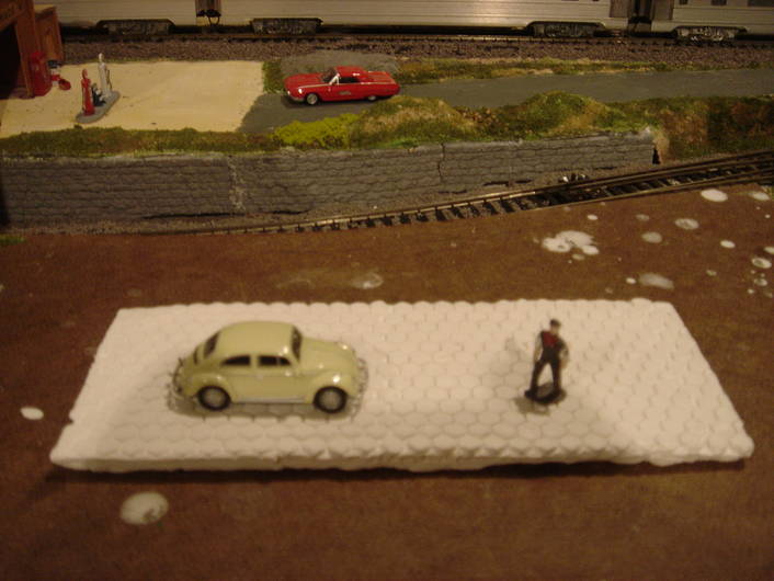

This is one wall I made using a Dave Frary stone wall mold. Part of the embankment is free, but I brought the wall up on the left side. The mold itself is actually about 3 inches high by 6 wide, so I cut this section out of it:
This casting was made for a turntable pit. It’s a tighter curve than you probably want, but it shows you what can be done with Hydrocal. It’s the same mold, just bent around a form:
Here’s a wood plank fence, which I use as a retaining wall. I glued coffee stirrers on to a strip of styrene. I applied a decal directly to the fence for the sign.
In the background here, you can see a longer retaining wall. This is a different Dave Frary mold:
