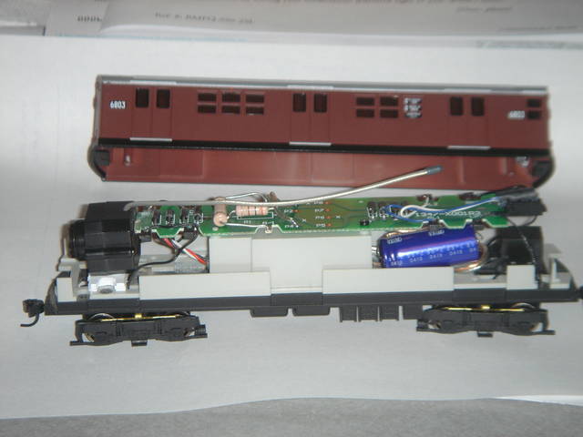

This is the equipment mounted inside the subway car. The camera itself is the small black cube, about an inch on each side, to the left in this picture.

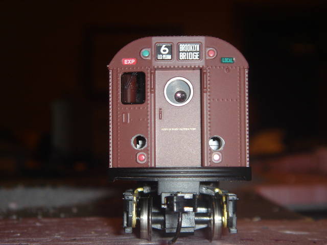

Here’s the view of the camera lens visible through the front porthole window of the subway car:
