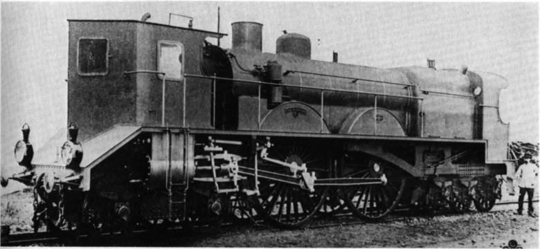

French “The Thuile” Cab Forward - a classy odd-duck
http://www.douglas-self.com/MUSEUM/LOCOLOCO/thuile/thuile.htm#boil
https://en.wikipedia.org/wiki/Thuile_locomotive
