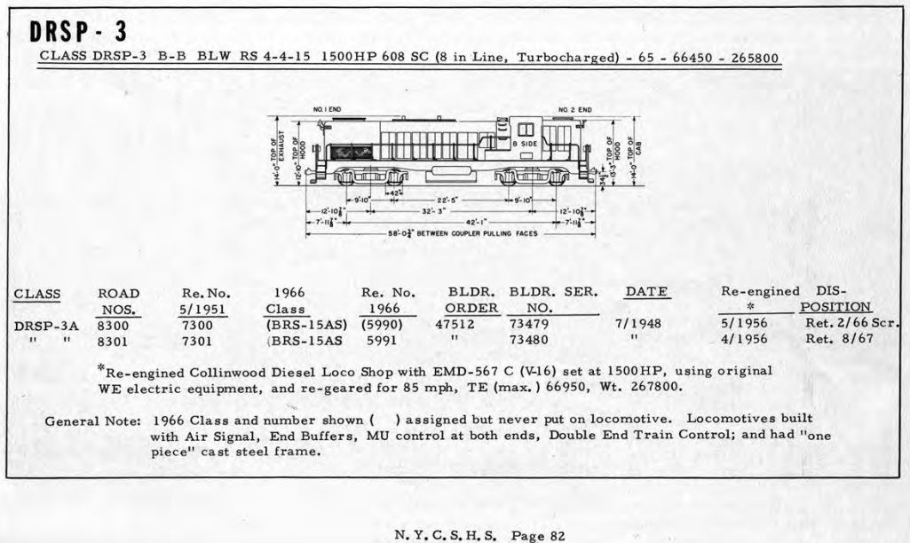

Thanks for the info! [:D] My copy of Later Power is buried in a box. However, I have a .pdf copy of the NYCSHS’s “Central Headlight - Diesel Roster Issue 5 - '77” issue that lists some of those dates/numbers differently. Pg. 82 states that the two DRS 4-4-1500s started out with road numbers 8300 & 8301 in Jul '48, were re-numbered 7300 & 7301 in May '51, and re-numbered again 5900 & 5901 in '66 before being retired in Feb '66 & Aug '67, respectively. And it lists them as being re-powered in Apr & May of '56 with EMD 567C V-16 engines, as you mentioned.

Thanks for corroborating that, Ed, and for the additional info. The “Central Headlight - Diesel Roster Issue” .pdf file shows more limited spec information:

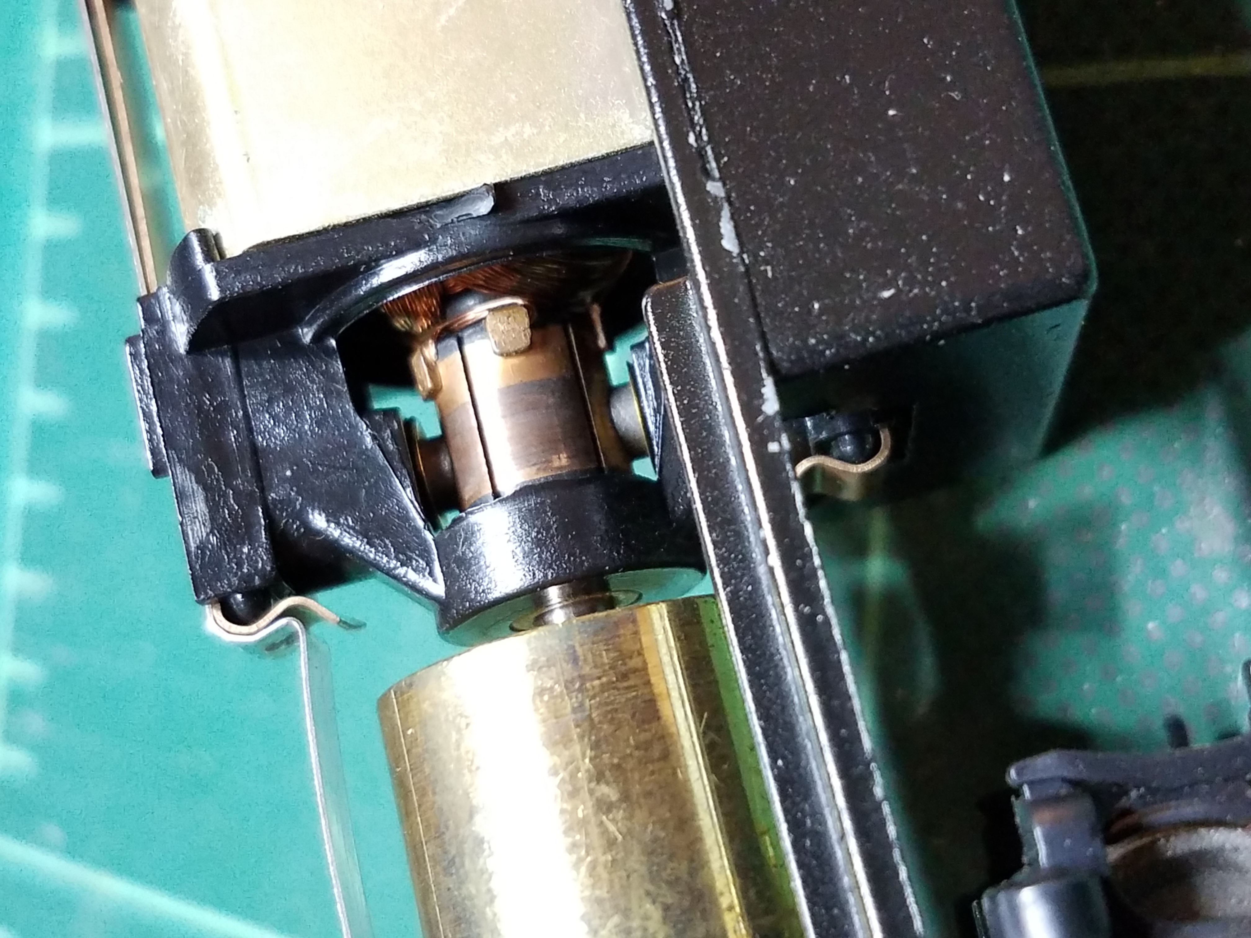

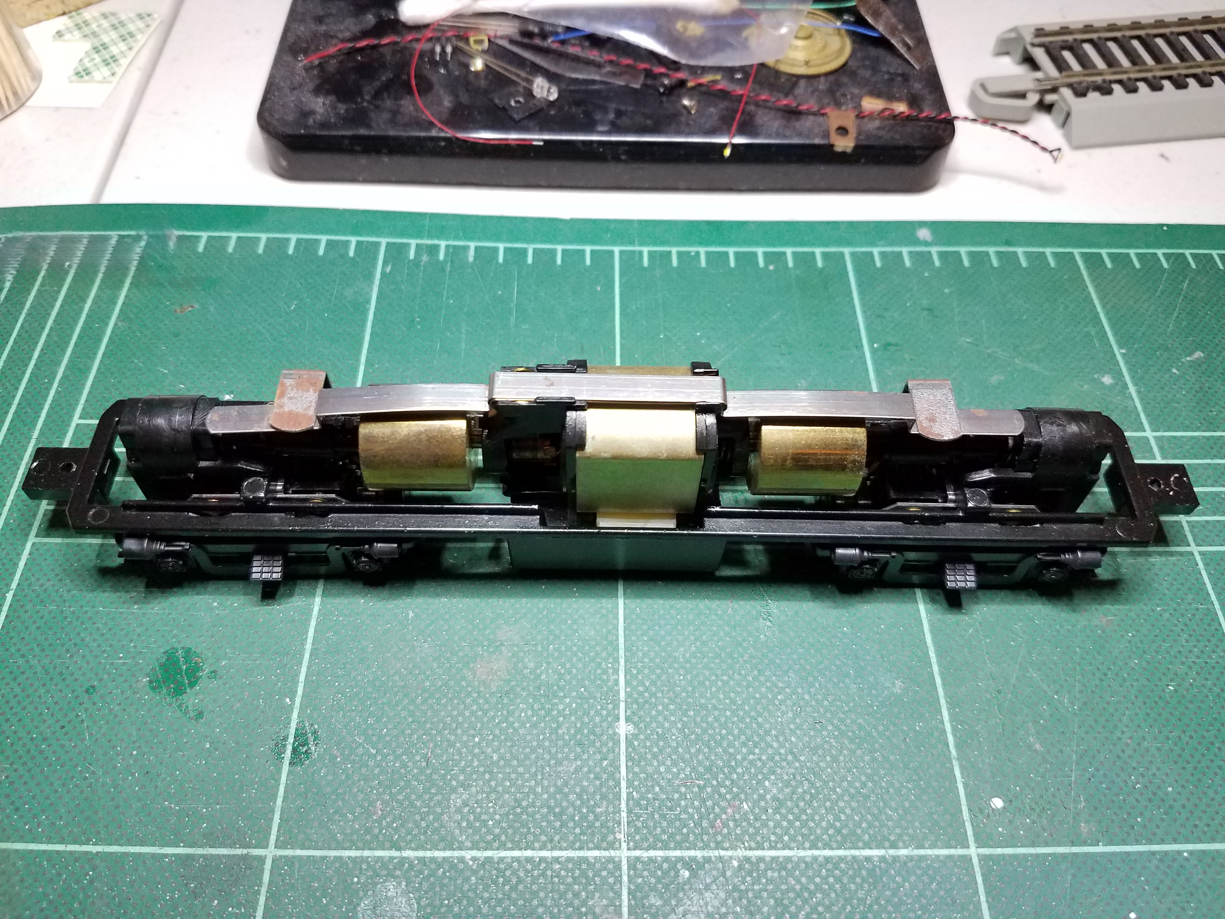

I received the Stewart AS-16 a couple of days ago. It apparently is a very early version of the model, as there is no 8-pin socket. There is, however, a “stepped” metal clip on top of the motor that makes the connection between the positive brush of the motor and the right wheels of both trucks. The left wheels complete the circuit via the chassis:

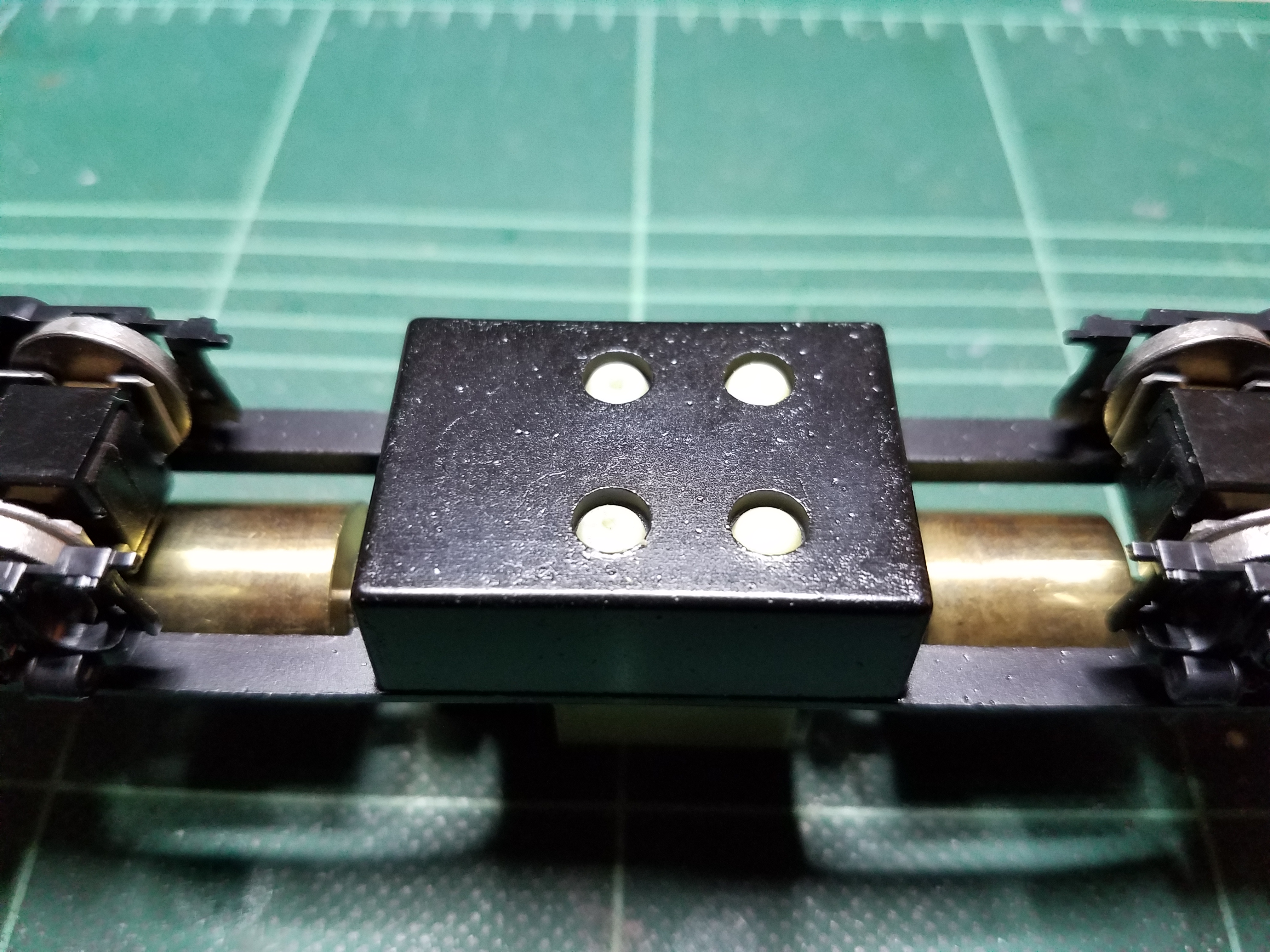

I’d like to isolate the motor brushes from the frame so I can install at decoder but I’m unsure how the motor is secured to the chassis. There are the four holes on the underside of the fuel tank (mentioned earlier by others) that are filled with some kind of soft backfill material:
Has anyone taken one of these apart? Are there screws underneath the backfill material?

Sure, that is basically a standard Athearn “blue box” system that has been in use for probably 30 years on Athearn engines.
The motor is symetrical, with a brass/bronze clip on the top and bottom that holds the motor together and retains the brushes. It is attached to the frame with four soft rubber “feet” (the white things you see on the bottom). The bottom motor clip has a couple contacts to connect the bottom brush to the frame.
You basically can pull the motor out of those feet or push up on the feetfrom the bottom to push the feet out of the frame. Remove the bottom motr clip and flatten the contacts flush. Solder a feeder wire to the bottom contact and then cover the bottom with electrical tape. Put the whole thing back together.
Search the internet for videos on installing DCC in an Athearn blue box engine if you want to see it done.
