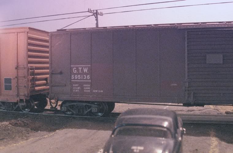

Some people airbrush a lighter paint, or you can do powders, and you can use some very thined out oil paints. I use powders to do my fade job. It works good for me. I also like to give certain parts of the car to really look sun bleached. Heres a picture of a before and after:

That’s what I do.

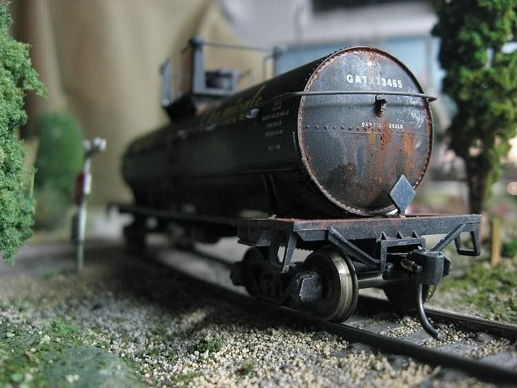

These all have some faded paint (especially the orange AA in the last image), thanks in part to the method Robby discribes.
