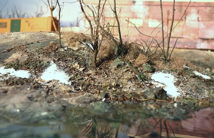

This suggestion may not work for trees in a pond, but for modeling driftwood and logs that have been in water for a long time I gathered twigs from a beach on Lake Superior. I’m sure that any beach where there is wave action would have similar debris.
I think these could be used ‘as is’ on a beach or painted with grey tones for deadfall in a forest. In any case, it took me about 5 minutes to gather enough of the stuff for about 100 layouts![;)]
Dave

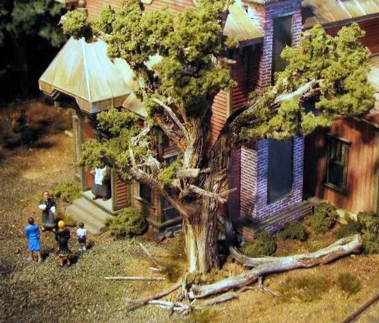

As mentioned, back yard or just keep your eyes open. These twigs turned trees were had from Utah on a family vacation where we went out for a picnic.

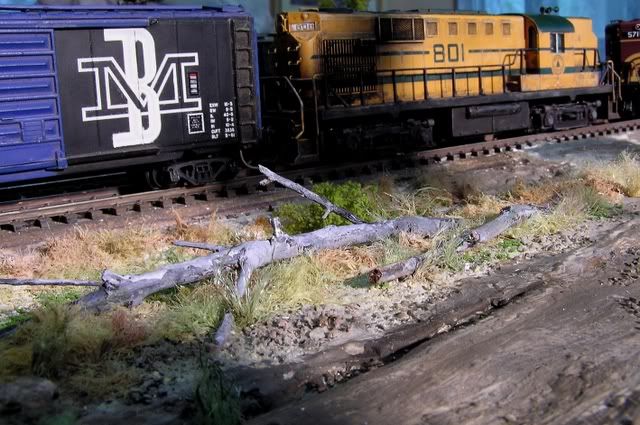

There are not too many limits on how big a fallen tree can be and still look right on a model RR. The same goes for stumps or a clear cut logging scene. The first photo of course is prototypical the next are on my model RR.
Peter Smith, Memphis
