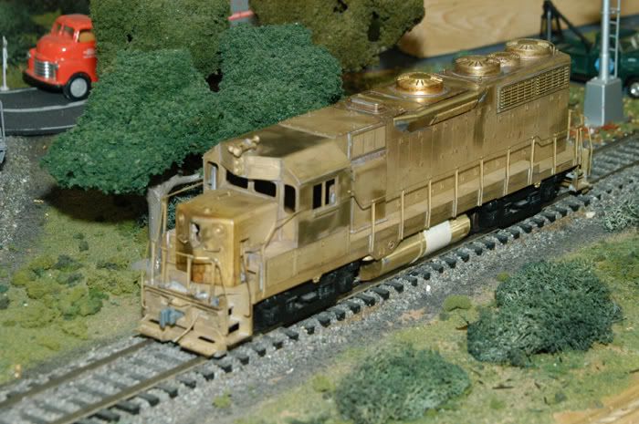

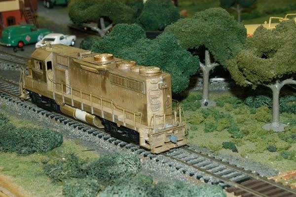

Here’s a few views of an older brass GP-35 in O scale I re-did
The tape on the fuel tank is holding it on, during mockup of the rebuild. I cleaned off any corrosion with a scotchbrite wheel in an air die grinder, smaller areas got hit with steel wool, followed by a good thouough cleaning.
