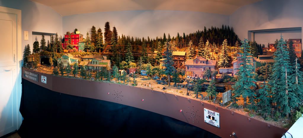

I just used curtain rods
I used velcro and attached it to the inside of the fascia board , my bride pleated the curtain every two feet and it looks great. It really adds to the overall effect of the layout.
