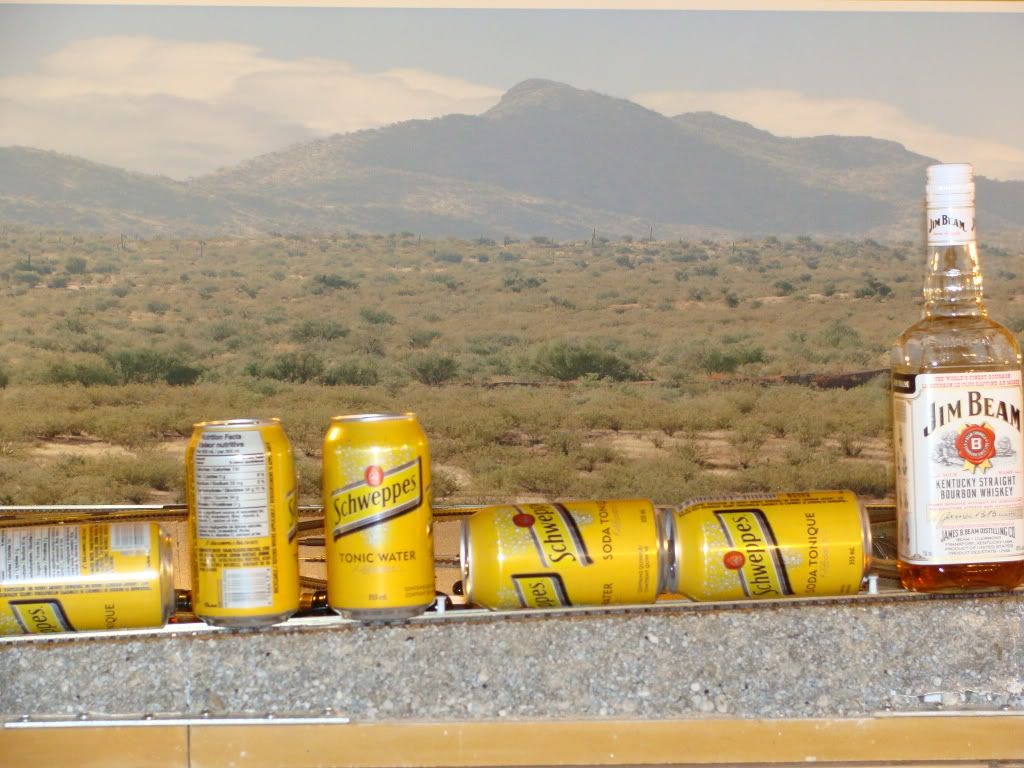

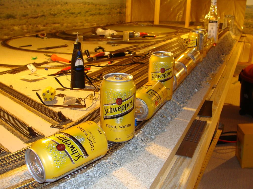

I use soda cans and Jim Beam bottles to hold the track down…oops, now you know why my rails aren’t always so straight.

What kind of backdrop you have in that photo?

The expansion of the layout is still in progress. Today I will be marking out roadbed lines on the expansion.
What you see is backdrop installed behind my old existing layout which will be connected with the expansion benchwork.
It is 22" high version of Wickenburg, Arizona scene in 4 twelve foot lengths from The Backdrop Warehouse. Expensive, but I think it is the best quality available. Particularly impressed with the media it is printed on…very heavy vinyl impregnated paper, almost leather-like.
