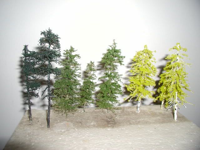

Good answers so far. I would add
Queen of the Praire, a flower, for Birch and Aspen trees.
Astibee, a flower, for tall thin Christmas tree, like Spruce.
Furnace Filter on a Stick for pine trees. This is the fastest, cheapest, easiest, way to fill a morthern forest.
I do like super trees, and Caspia in a dowel for Norway Pine.
twisted wire and sissle rope fibers, trunks are a bead of glue and fine saw dust sprinkle. I also use furnace filter. And some polyfil “lollipop” trees.

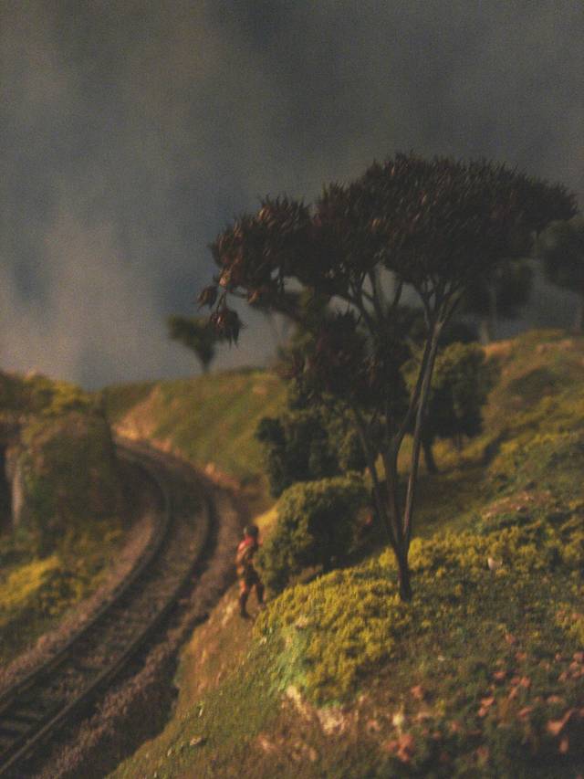

The trick to making the sedum more effective is to combine several stems to create a more 3-D crown. By themselves, they look a little too much like umbrellas. Here’s a link to my tree page that gives you a little tutorial…
Here’s the results:
I also recently discovered that the Butterfly Bush in our back yard produces a nice tree armature… and lots of them!
And remember, trees are anywhere from 10 to 80’ feet tall… don’t make yours too stumpy…
