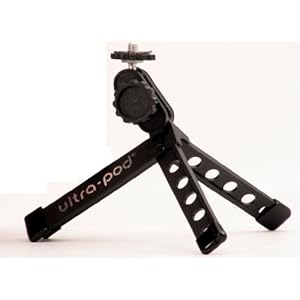

I purchased an ULTRA POD many years ago and it really works great. I have taken it on vacation and used it to take the obligatory photo of the Mrs and me at the scenic outlook. See photo and description below. I am also able to set my camera on the layout and use the timer under less that adequate light with this little tripod. It works great for train videos, too. Amazon.com had them for less than $15.
Pedco UltraPod Lightweight Camera Tripod
Description: The lightweight UltraPod is a mini, injection molded dynamo. It stands on fold-out, no-slip feet, or attaches to solid objects with a Velcro strap. Ball and socket mount assembly adjusts to multiple positions quickly and easily: UltraPod Mini Features: 1.05 oz. Will support cameras up to 1lb. Folds to 4". Velcro strap. Will attach to 2.75" Diameter objects.
Here is a photo taken with the tripod last summer on Jon’s layout in Iowa with no flash with camera on the UltraPod.
