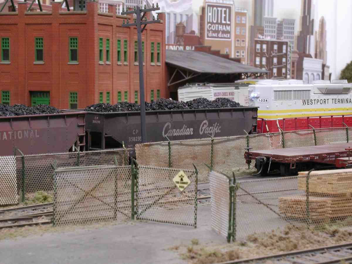

The square-wire fence in this photo is nylon window screen painted gray to simulate galvinized steel fence wire. The posts are satin pins. All tyhe materials are available from Wal-Mart.
I used the Tulle from Wally World to make the fence on my Overpass bridge. It cost me just over a dollar also and it’s enough to make miles of fence. I used the silver colored tulle and it looks like chainlink/cyclone fence. The posts were made from brass rod.
I found this easy to do and it came out very convincing… I think.
